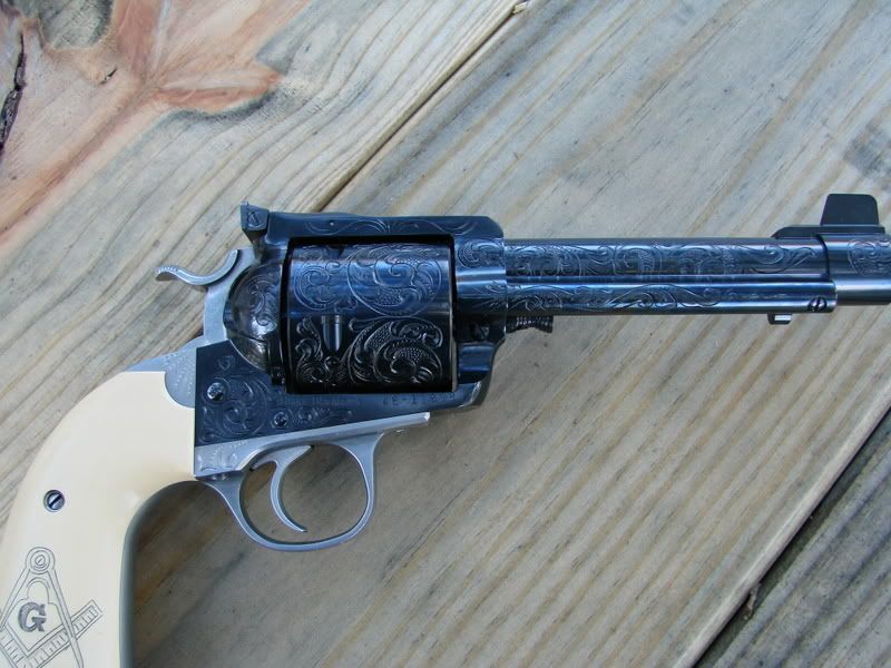

Before I had my Linebaugh engraved, I shot some wet paper with it.  Those 830 fps loads would consistantly penetrate better than thirty inches of packed wet newsprint.  I have yet to have on stay in a deer or a hog.
Engraved, it does not shoot any better, but it sure looks good!

« Reply #22 on: May 31, 2008, 03:32:39 PM »
Awesome gun you got there Scott.

« Reply #23 on: May 31, 2008, 03:43:15 PM »
Scot, I see you belong to a blue lodge? I'm a llife member of Pontiac #294 and twice past master.

« Reply #24 on: May 31, 2008, 04:50:42 PM »
I am a Mason, and current on my dues card, but I am not active in a lodge here.  My home lodge is about 200 miles away and I need a new home.  I was in the chairs when I had to relocate.  Something else I need to finish up.  God bless.
