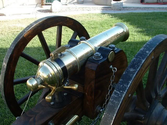

 Well, it's here. I'll post a report tomorrow when I get a chance. If, you have any questions please PM me and I'll try to include them in my post. I can tell you that Tropico's post is pretty much "Spot On" regarding the tube.

Pretty cool looking piece ... Love your Corgi !! you already know my next request Fire & Smoke Please... :D Ed

Wow I like that percussion cap slap hammer ya got there  ! .,It is the same barrel., and yea i am happy with it .,please don't anyone get me  wrong.

The tube on this piece is 20.375" in length. Not the 22" stated by wildimports. The liner is not stainless as with Tropico's and does not seem to be seamless.  The wall thickness in the breech area is 1". I am still happy with the piece but, would NOT fire a solid projectile from it. I am still baffled by wildimports website stating that it can fire a 44mm lead ball. I would really like to hear from them telling us more about their liners. Maybe one of our moderators could give them an open invitation to this website and posting. Who knows maybe they can straighten us out in regards to their liner and maybe even become a Sponsor.
The bottom line is that I still like the piece as it looks good and is flashy (must be a Vegas thing). ;D  If you are looking for just a noise maker and intend to fire golf ball or two then I would recommended one of our sponsors golf ball cannons as they would be more of a workhorse and save you a few $$$ too.
I hope this helps with your decision. If, you have any other questions or, need certain photos just let me know and I can provide those for you.
That's is one of wildimports add on's. I think the original owner paid $75 for it.
