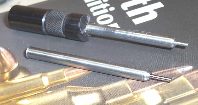

Here's the one I fixed up. It is a dedicated tool for just the .204 as the threads are secured with thread-lock to prevent movement.
If I make another one I'm going to use the mandrel from a collet die (as shown in the picture), cut off to a proper length and cut 10-24 threads to fit the cutter. I prefer the hardened pin used for the decapper. The newer LEE case length gauges no longer have the hardened pins.

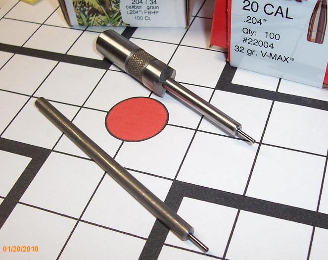

Discovered that the LEE Universal Decapper Pin has the same diameter as the .204 Ruger collet mandrel and they are $2.00 each from LEE. So today I cut one to (approximate) length and threaded the end and this is what it looks like after final adjustments:
A LEE decapper pin in the bottom of the picture
