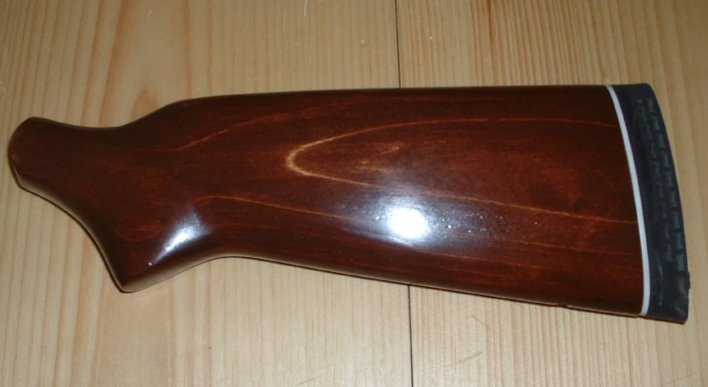

Re: WTB an old style huntsman or shikari stock
« Reply #3 on: November 28, 2006, 09:02:49 AM »
These MSP? ;D
« Reply #5 on: November 28, 2006, 09:37:13 AM »
Those are MSP's refinished pallete wood stocks, but I don't know if they or it was originally a straight or MC stock. It's the only pics I have that I posted for him.
« Reply #8 on: November 28, 2006, 10:44:21 AM »
Thanks Quick!!, that was an old (see the style of the original red colored recoil pad?) pistol grip non Monte Carlo stock that I made into a straight stock for Tallyho. It was pallet wood but since it was so old it might have been a different wood than the new pallet wood stocks. It was very close grained with little sap wood and it did come out to look just like walnut. I have been able to replicate a pretty close to walnut color on some stocks and yet some others just don't quite make it to the color I prefer, the biggest implement to looking like walnut is the grain of the wood really, most colors can be matched pretty closely through experimentation. Someone here has just recently posted a picture of a redone stock set with nice faux fiddleback grain in them. I would like to locate that post and contact the member to pick his brain on how he did it, years ago some stockmakers would soak a string in something (I forget what) wrap it around the stock from one end to the other about .5 to 1.0 inches apart on the wraps and then light the string and let it burn it's way from beginning to end, when completed that did a fine job of looking like fiddleback. There is another picture somewhere, pretty close in time to the one Quick posted of a standard brown laminated Monte Carlo buttstock that I re-did into a straight laminated stock after someone here aaked if they were available, I finished that one in a sort of Rosewood stain with a Tung Oil finish and it now is on my .35 Whelen. I posted pictures here of that stock also, I just don't know how to locate them with this new search feature, I cannot seem to locate much of anything with it, all I seem to get even when I check off Search/GBO are internet listings ???....<><.... :)

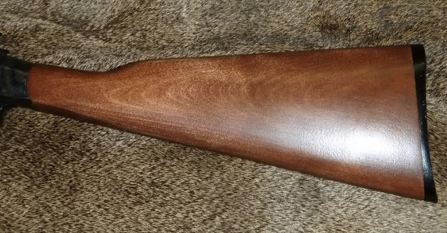

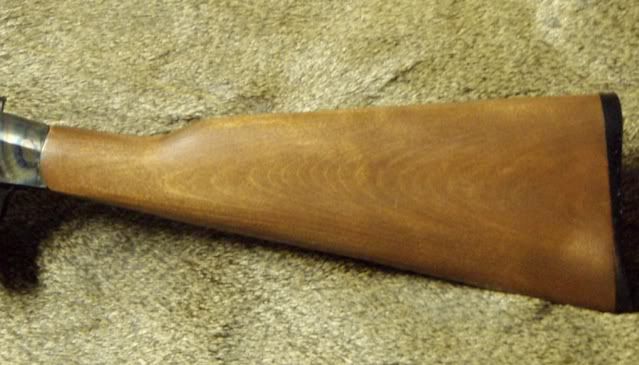

I think this is one of yours too, isn't it?
« Reply #10 on: November 28, 2006, 02:30:49 PM »
I forgot I had one of MSP’s stocks on the .30-30 Topper I bought from Tallyho, here are a couple pics,  first one is without the glare, second is what it really looks like…er…as  close as my photographic skills will allow!! Got  a new camera, still learning how to use it!!
« Reply #11 on: November 28, 2006, 04:24:14 PM »
Thanks Quick, and yes that darker pistol grip stock is one of mine  (it looks darker in the picture than in real life), as well as the one on your 30-30. The pistol grip stock started out as a standard brown laminate Monte Carlo of the type that replaced the standard palletwood a year or 2 ago for a while, not one of the fancier lanimate's. I took it down to a standard comb and used several coats of Minwax water based rosewood stain to get a darker reddish rosewood color and then put on 4-5 coats of WaterloxTung Oil. I may change it at some time but for now it looks good on the .35 Whelen.
