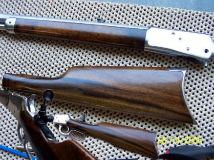

I would suggest for your 92 is the MARBLES tang peep sight.
www.midwayusa.com
has them on sale for a bill,you can get the lyman a little cheaper but it has no windage adjustament.The only way to adjust it on the lyman is to use a shim.On the MARBLES it has windage and elevation.I have one on my 92 posted above and couldnt be happier
STEVE.

steveb3006
Member
Posts: 33
Gender:
Rossi 92 peep sight?
Reply #5 on:
October 22, 2005, 07:03:48 PM »
heres another view with the sight up.Its a pict from my recent refinish job
