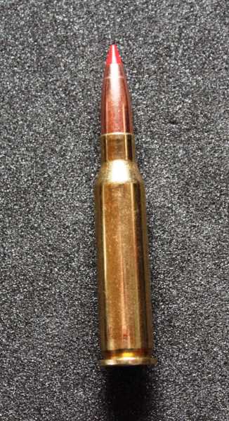

I just wound up with a Handi in 7-08 that I didn't have a real need for........  Hmmmmm......  I can't wait to see a picture!
From the outside it will appear just like any other Handi rifle. The rim counterbore is the only difference. ;)
I could take a pic of a dummy round I assembled today. Is that something you would like to see?

I'd like to see a assembled round Dinny

Here's a pic of the dummy round with a 120gr Nosler BT loaded.
