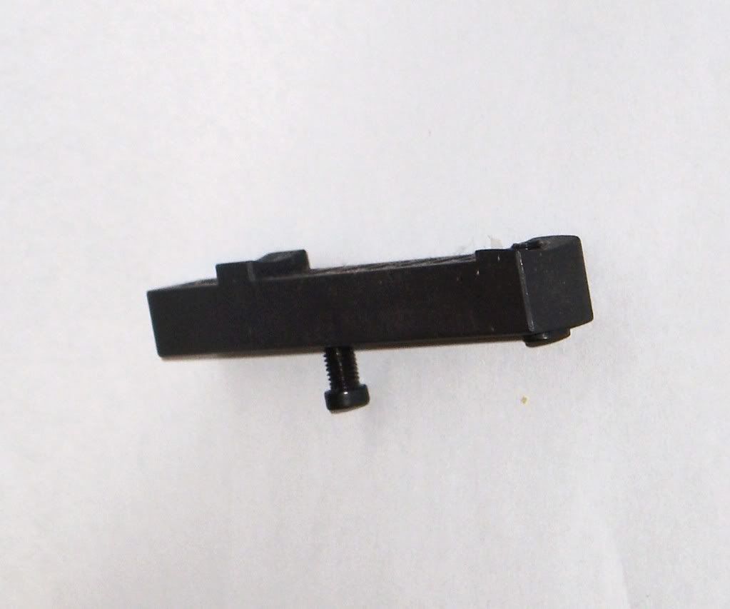

This is a Stratton Custom hanger-bar for an Encore factory 15inch barrel. It requires a modified factory forend or a custom and allows the barrel to float above the forend when properly executed.
Here's anther hanger-bar installed on my 5.7x28 full bull barrel by MGM
Also note that if you go that way on the Encores you have to order the correct bar for the contour. On the Contenders you order it for either the pistol length or the rifle length
docand

Picture of a forearm inletted for a H-Bar. As said there are more than one way to skin a cat, but I do like the H-Bar system.
