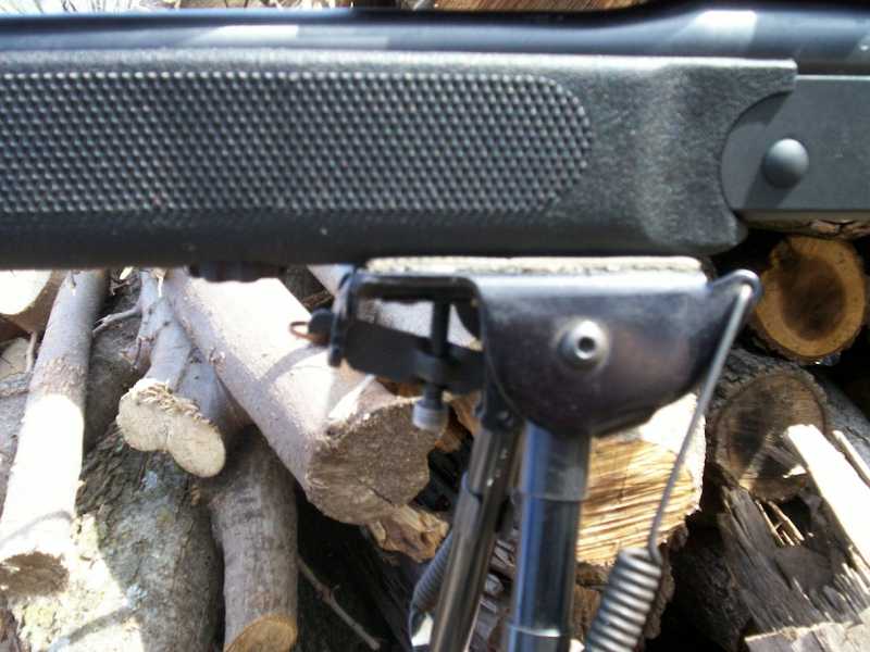

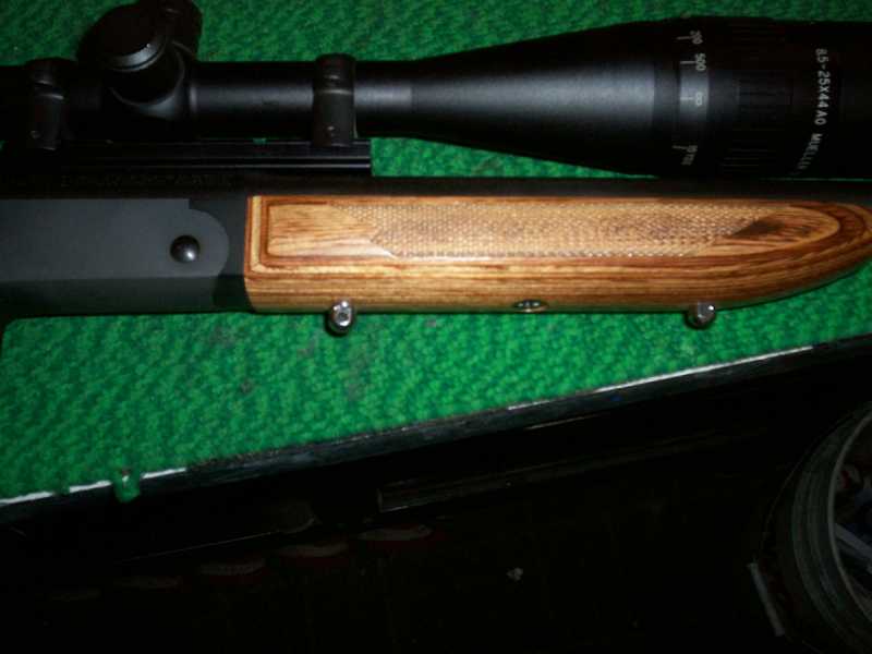

Offline Slowhanddd
  • Trade Count: (43)
  • Posts: 691
Re: bi-pod on a handi...
« Reply #5 on: December 17, 2009, 08:52:26 AM »
Ok here's the pictures.My EBR 223 and my lammy 17M2.The bi pod does work just fine and the accuracy is still there.Just like bags.This bi pod is the 13"-23".Just right for sitting with your back against a tree or bush.Slow
you bounce

Offline Lon371
  • Trade Count: (53)
  • Posts: 2486
  • Why Not a Handi?
« Reply #8 on: December 17, 2009, 10:27:01 PM »
Slowhanddd
Nice set up. Thanks for the picts.
