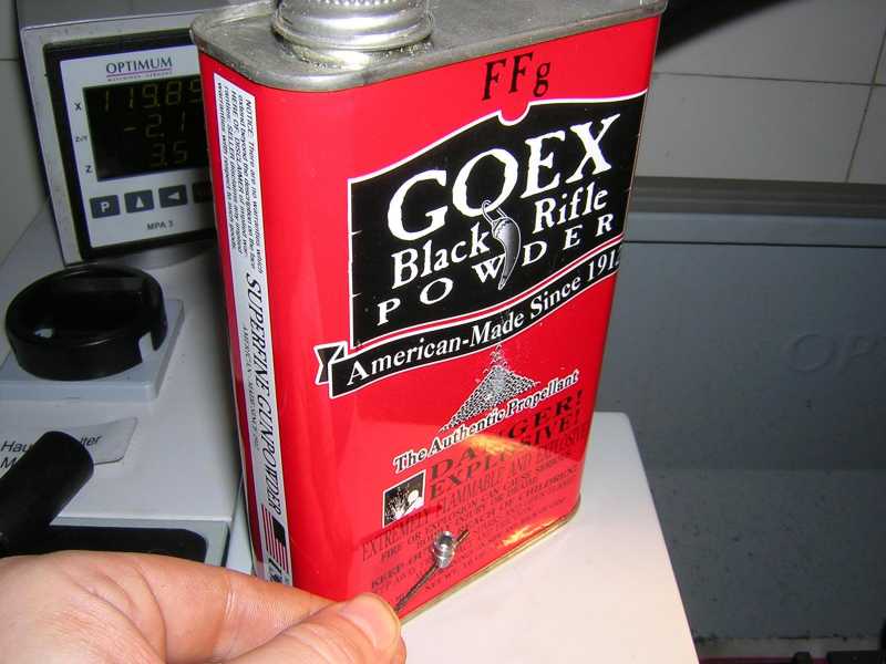

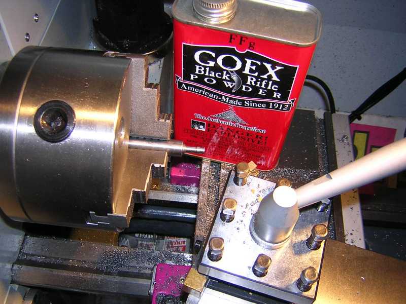

It's been some time, since the micro mortar was discussed about on this board but I just finished this one...
Please consider: I just got my lathe lately and I still need to learn much about using this tool efficiently...

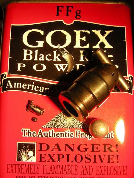

The pictures above show the 3mm (3 millimeters = slightly over a 1/10th of an inch in projectile diameter) coehorn mortar besides a Caliber .45 coehorn.
Both should be as close to the drawings as I can get by now...
BTW: This is a great forum!
Jorg (from Germany)

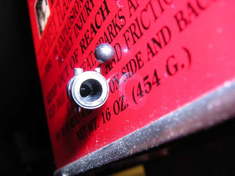

Yes, of course they are functional!
I need to build the mortar bed still (from wood) and find a way to manufacture the screws...
That's something to consider, since with such a small mortar the screws holding the bed together are EXTREMELY small!
BTW: The 3mm mortar has a powder chamber as well: it is 1.7mm in diameter...
You need to have a very fine granulation of BP to fill this thing...   ;D

what diameter is the touchhole ??

Until late this summer I didn't own a lathe, so my very first model of a mortar was done by using a drill press and some files. This one was caliber .177" (4.5mm) and out of scale in some dimensions, since I just had some bad pictures as reference back then. Later I bought the re-published drawings from Don and Jan Lutz of the civil war Coehorn mortar.
I really like the design of it: everything just fits.
My first model with the new lathe was the cal. .45 mortar you see on the 3rd picture besides the "pico-mortar".
(Actually I missed the topic, where you defined the "official unofficial scaling guidelines"...)
I tried to come closest to scale with my limited experiences on a lathe. But for a start, I think it's quite OK.

I bought the lathe with a display for the coordinates (no clue what the proper English term might be). By the time I finished the cal. .45 mortar I learned it to be a fine gadget. While I already did the BB-size model I wanted to see, if I could minimize it even further. In search for an easily available source for projectiles (I didn't consider casting for a single second), I noticed that within a shotgun shell there's plenty of them in quite uniform diameter...
The touchhole actually has two diameters: It is .5 of a millimeter all the way through (to retain some pressure ( ;D !) in the chamber) and on the outside it's 1mm for the fuze. That's the only detail on this thing that isn't in scale. I even used the 6 degree taper at the chamber area. The trunnion is also late turned and silver soldered in place.
Actually I need to make my own quick match for it: since even the smallest commercial fuzes are just to big for this thing. I'll be using a very fine granulation of BP used for priming flint-lock muzzle-loaders. It is basically dust. I'll post some pictures when I'm done with the mortar bed.
