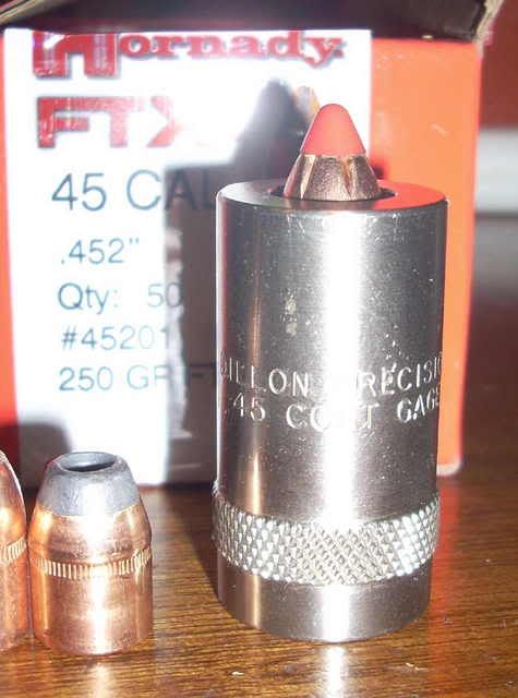

I prepped 100 45C cases today for some FTX bullets. I used some purty virgin nickle Rem/Peters cases. ;D ;)

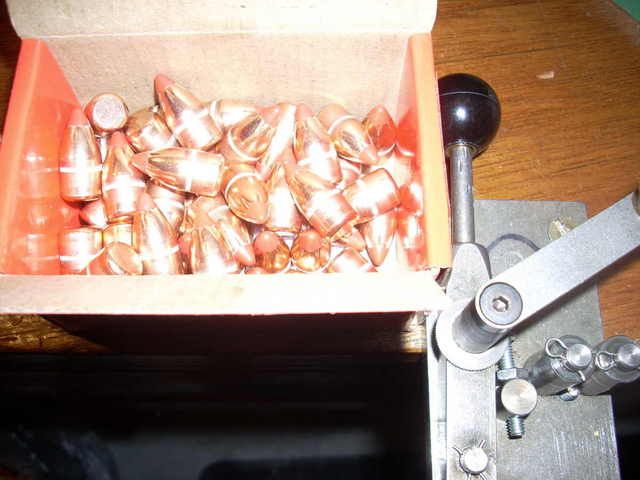

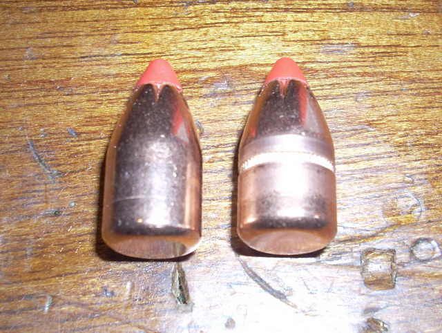

 I forgot that the 250Gr FTX's don't have canalures. I guess that they where designed for the 45 SoCom. Being its an auto it must taper crimp. Anyway, I mounted my C&H canalure tool and calculated where I wanted the canalure. All of these weigh 250Gr.
I put it on so the bullet is only in the case about as far as a 200Gr would seat. I checked my gages and the chamber on the handi. Now this will never work in my revolvers or levers. its strictly a SS proposition. here is a couple pics:
The tool works very nice and easy. Just a bit of pressure and turn the crank. I took a little video of it in operation.

That C&H tool makes a very nice looking cannelure.
Can the tool be used for all calibers?
Do you have to buy caliber specific accessories?

 I have only used it for 357 (9mm) & 45. But the size and diameter is adjusted with a screw thread. So I'm guessing that any caliber could be made to work pretty easily. It works nicely and is infinitely adjustable.
