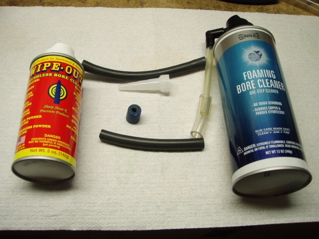

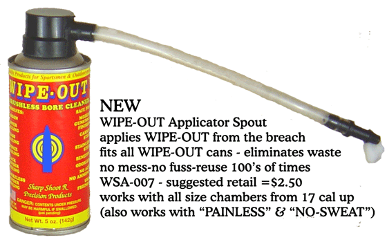

Re: Copper remover
« Reply #5 on: November 24, 2008, 12:01:25 PM »
A second vote for WipeOut if you want the easiest and most effective solvent without any bore scrubbing and without the time constraints on allowing it to work as there are with ammonia based solvents, the other foaming cleaners are almost as good and easier to find tho, but the new WipeOut dispenser tube looks to be nicer to dispense the foam from the chamber end, haven't got a chance to try it yet tho, Sportsman's Warehouse only had the old style in stock which works great with the right tubing combination to get it in the bore.
http://www.sharpshootr.com/
The heavy duty ammonia based copper solvents like Montana Extreme, Sweet's and Barnes CR-10 work great for cleaning light fouling between shots during break-in tho, but for heavy duty cleaning overnight, nothing beats the foaming cleaners that require no elbow grease or brushing, just a couple patches. ;D
I've refined my application technique that makes no mess, just slip a wide mouth drink bottle over the muzzle, and using a piece of tubing over the nozzle of the foaming cleaner that fits the chamber snug so the foam can only go down the bore making for a nice application. Once you learn how much "trigger" time on the button to get the foam thru the bore without an excess accumulation in the bottle, there will be less wasted cleaner.  The bottle works great to collect patches too when the time comes.  ;D

Re: Copper remover
« Reply #6 on: November 24, 2008, 03:40:56 PM »
I'm with Tim.  I've only used the Gunslick brand, but it worked good and I could do something else like talk to Mama.  Then I can go back in my room and not get into trouble with her. ;D   She's really good about it, but with her working 12 hour shifts at night and me doing 11 hr. or so days, it's nice to see her once in a while. ;)   This is wife number 3 and she's better than the first 2 added together and then times 10.  If I even mention a gun she just tells me to go get it. :o  I'm keepin' her for sure. ;)  DP
