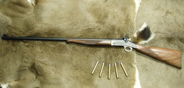

A Handi Hornady 450 N.E. 3 ¼ Rifle

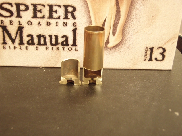

I use Starline brass from Buffalo Arms for my 45-120.  Starline does not make 110 or 120 brass in .45 cal.  The stretched, made from Starline 2.6 brass is thinner and weaker.  I have approched the above velocity with no problems.  The brass is unsafe at that pressure.  The slight increase in powder volume will put working pressures at about 35,000 psi (Hornady working pressure), well within Handi limitations.
Hornady wants this cartridge to be used in the fine old English guns.  They don't have to incorporate English primers into the new design.  The brass, which won't be available until probably late in 2009, probably will use Federal primers.  By then 4-D Reamer, Clymer,  & Manson will have reamers for the Hornady 450 N.E. 3 ¼ – The “grandfather” of the classic 19th century DG cartridges.
Note, I do not have sworn statements attesting the validity of the above conclusions but the facts speak for themselves.

Re: A Handi Hornady 450 N.E. 3 ¼ Rifle
« Reply #1 on: March 07, 2008, 04:24:13 AM »
And the hornady 450ne3-1/4 ammo is only $118 a box.   ::)
Sorry, but I think a lot of us would agree, if we had that kind of money to throw around, we wouldn't be shooting $200 guns.
« Reply #2 on: March 07, 2008, 04:47:13 AM »
And the recoil in an eight pound rifle would be murderous! If one can afford an African big game hunt they probably can afford a serious rifle in which to shoot that round.
« Reply #3 on: March 07, 2008, 04:48:28 AM »
While i like the concept , with the 45/90 , 45/110 and the 45/120 being so readily available I'm not sure their will be many Handi's done this way .
« Reply #4 on: March 07, 2008, 04:51:33 AM »
I didn't think about that!  I haven't bought factory ammo in 35 years!  I was just hoping some of you guys would buy enough of that $3.50 ea. brass to drive the price down!   :o
« Reply #5 on: March 07, 2008, 05:19:20 AM »
The hornady brass will be about $2.80 each.  But... will they tell what kind of proprietary powder they use to get that kind of velocity out of 35,000 psi?

« Reply #6 on: March 07, 2008, 05:56:57 AM »
I'll stick with the 45-120, Norma and Bell brass are less than $2, Bell brass is good for 60kpsi according to Mast technology. I've done some research on the 450NE, the 45-120 loaded to modern pressures with smokeless powder in a BC is no slouch. Case capacity of my fire formed brass is 124gr water compared to 119gr for the 450NE.
450 NE data isn't easy to find, but I did find some listed in an ADI .pdf as well as on the ADI website, they also list data for the 45-120 including several Hodgdon powders.

As far as weight and recoil are concerned, a lead dead mule or MRS in the stock bolt hole and a leather slip-on recoil pad like the Galco go a long ways to tame recoil, I've pushed the 555gr Saeco #20 to near 1800fps in my 45-120, shoots great, recoil is noticable, but not painful. ;)
The data that follows is only a prediciton using software, no powder had been burned....yet.
Here's a what the 400gr Barnes SSP at 2650fps might do, that's with a QuickLoad prediction with a case full of H4895 with pressure <50kpsi, still within the operating pressure of the 500S&W which is factory chambered on an SB2 frame with a larger case head than the 45-120, the 45-120 would have less case head thrust also due to considerably more case wall contact surface. Exterior ballistics calculated with Sierra Inf 5.1

four thousand nine hundred thirty ft.lb. that heap big tip over medicine. ;D Kurt

My comparison data came from wickipedia.  The diameter at the base was slightly larger than 45-120.  Quick's data showing the 45-120 with more water volume confirms my statement of the thin brass in the 45-120  that Buffalo Arms sells as "Starline Brass"
It  is actually Starline 2.6 brass that has been stretched to a length of 3.25" by someone besides Starline at the request of Buffalo Arms.  I don't have any Hornady brass to use for comparison but I would bet it is considerably heavier because it is a lot thicker and the volume inside is less than the 45-120.
Starline told me that they did not make 3.25 brass but they would be happy to do it for me if I ordered a minimum of 25,000 pcs. and paid a $500.00 setup fee.
Actually I said that I had approached those velocities .  I would not shoot the same piece of brass twice.
To me, that brass at $1.56 is more expensive than $2.80 brass that I could safely reload 4 or 5 times.
Besides all that, who said, "Daydreams had to be economically feasible?

Bell 45 Basic brass has thicker walls at the case head than Starline 500S&W brass, and like I said, it's tested to 60kpsi, dunno about Norma, don't have any to section. Track is out of it now, they're accepting orders, but until Jamison(who bought the machinery from Mast) runs some more, they won't get any, it was $1.96 each.
Grafs had 450NE-3¼" brass if ya wanta go ahead with it, but I don't think there's any serious advantage to it other than something different and brass costs even more, they both have the shock and awe factor!! ;D At equal pressures, the 450NE would have more case head thrust due to the larger .540" case head.

PC, a dead mule is a brand name for a recoil reducing device, a lead weight in the stock performs the same function without the springs.
