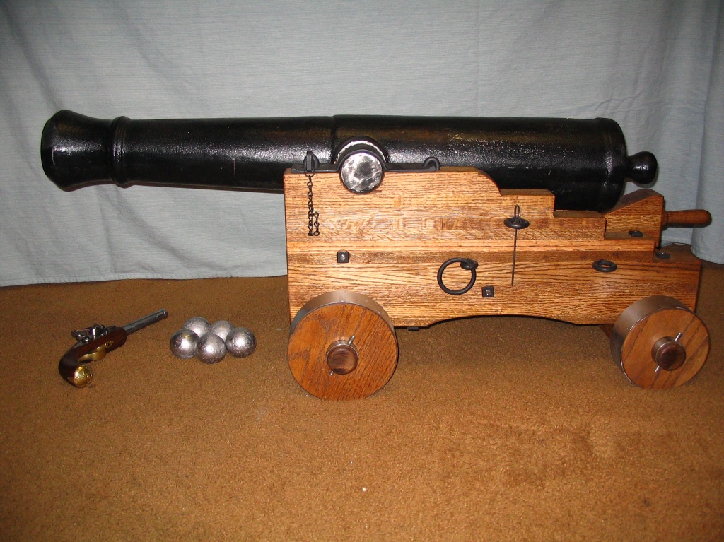

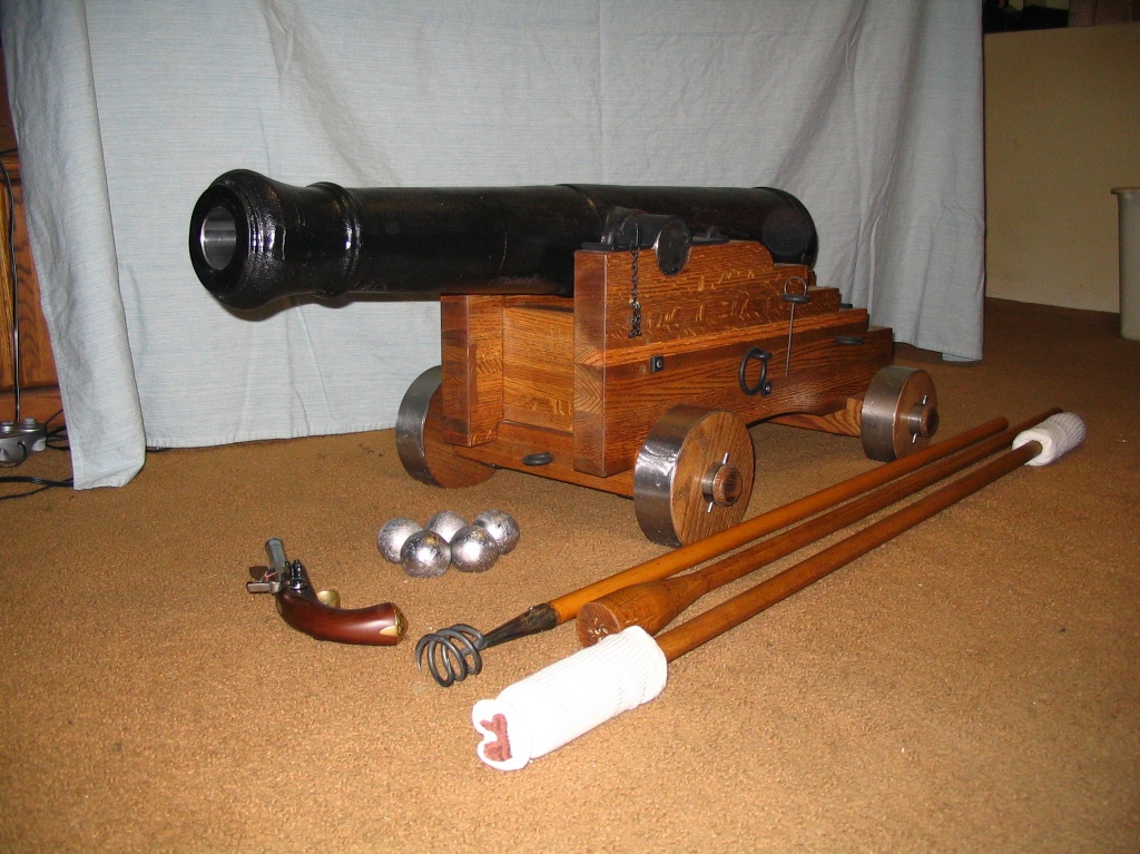

It's been completed for 6 months and I still haven't fired it! It's a 2/3 scale 6# by Hern, the carriage is a laminated 2" red oak patterned after South Bend Replicas drawing. For scale I laid my 50Cal Queen Anne pistol in front of it.

I been waitin fer this...,  Very nice ! ! ! Congratulations !!!  That Cannon project came out really great . I really like your carriage .,  more pics., more pics .

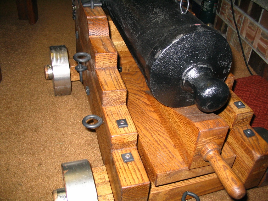

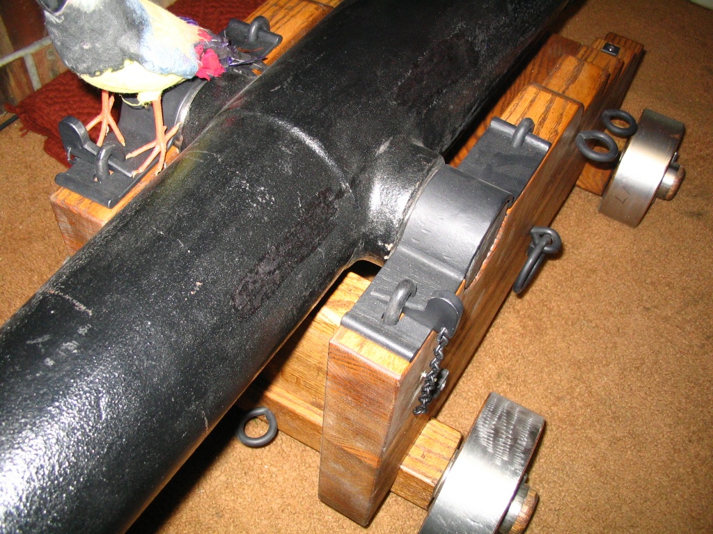

Now that I learned how to do this, here are some close ups of the naval gun.

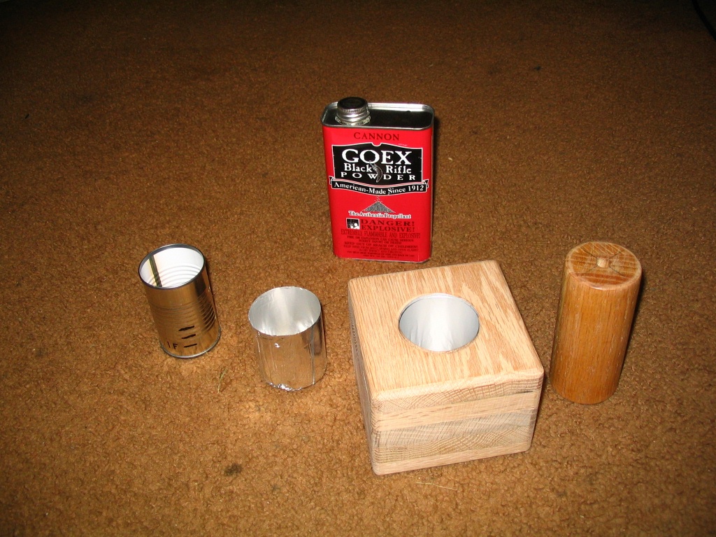

Heres some stuff I made to make the charges

Very nice  ! Did you make the trunnion caps yourself? They look great !!!

Yeah I did make the trunnion caps and wheels, the trunnion caps took a couple of tries before I got what I wanted with heat and bar matching the trunnions dimensions on the gun, the wheels were probably the easiest as well as fun making compared to the rest of the carriage. The axles are wood also with steel sleeves, the steel on the wheels were a bit tough tho, I formed the steel around the wheel and cut them short to create a .060 gap and wire fed them closed which caused them to shrink and stay on ( I guess it's a modern way to install tires on the wooden wheels). The whole project took over 2 1/2 months to complete.

Pic No# 4 does alot for me....,I really like the way this whole cannon came out

I agree , the attention to detail really makes itself evident it pics #4 & #3, wish I had that kind of talent with wood. Great job on the trunnion caps also.    M223

Beautiful gun. You should be very proud. I also like the cartridge making process. Now get out there and burn some powder!
