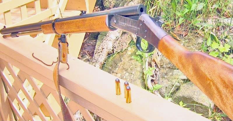

Would like to purchase a .22 Hornet barrel for my 1973 H&R Shikari 44 Magnum. Do you know if a new barrel would fit this oldtimer?
I may need an older barrel, right? Do all Hornet barrels come with a scope rail?
Thank you very much
Have a good day
Martin

The hornet comes with either open sights or a scope rail. H&R/NEF will not fit barrels with an asterisk to frames made before 1999. Hope this helps.
Re: Hornet Barrel Question
« Reply #2 on: January 16, 2007, 05:43:36 AM »
Welcome to GBO, Martin! H&R NEF won't fit any barrel to frames made before 1987, and my guess is that a current model barrel wouldn't fit any way, you would probably need to find an older Hornet barrel to fit it. The reason I say that is I have a 1972 Topper 158 .30-30, the underlug is about .080" too long to fit any on any my modern frames, it would take a lot to make it fit, so that means a heck of a big shim would be needed to make a modern Hornet barrel fit your older frame if they're all that way. :'(

Since you're living in Canada, the accessory barrel program is probably out of the picture for you anyway.
The hornet is a great way to go a complete rifle is probably you're best bet; you'd need a different forend too I'm thinking.
good luck!
PS- That Shikari is a nice outft!

Thank you very much! I'm now on the hunt for an older Hornet barrel. Shipping a barrel to Canada is not problem. :)
M
