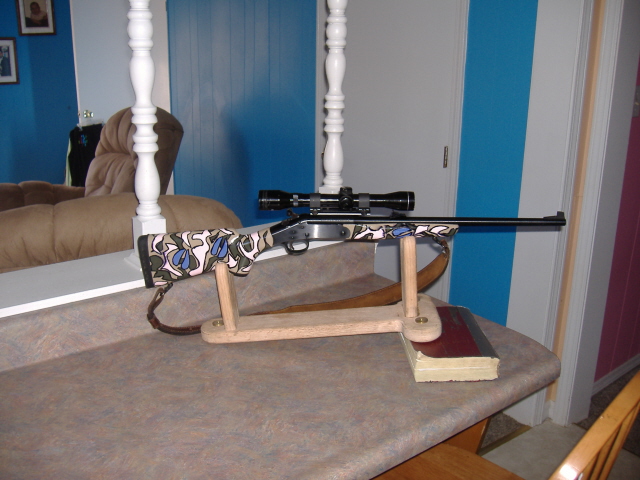

FredM,
Thanks for the advice. I got the stock done now and I think it looks great. I will try to get some pictures taken and posted for you in a few days. If this isn't already on FAQ's I think maybe it should be added. It was very informative and able to be followed. Thanks again!
Navylawdog
navylawdog.
Start with sanding the stock smooth, without rounding any edges. Brush or blow
off the dust and wet the stock to raise the grain. Let dry well and sand the wiskers off with a sharp new piece of 400 paper.
Wet the stock again and do the same thing let dry and sand. Blow off all sanding dust. Get a role of 3/4" scotch tape and wrap it around your four finger with the
sticky side out. Wrap until you have a sticky sleeve abvout 2" wide and go over the whole stock with the sticky sticky side.
This will remove any embedded dust particles. You are now ready to apply
Birchwood Casey True oil with a bit of turpentine added to slightly thin it down for the first and second coat.
Each coat is sanded down to the wood and the dust removed with the tacky scotch tape. Use the oil sparingly with no visible build up. Do this until all pores are filled
and the grain starts to look good. The number of coats depends on the wood.
Apply the finish with a lint free cloth made into a ball, apply the oil to the cloth ball
and rub in on the stock with out build up. Let each coat dry good.You will know
when the stock is finished,always sand in between coats and use the tacky tape
after before a new coat goes on.  Ten thin coats should do it.
This will make a finish that is in the wood and is easy to touch up when damaged.
You can do the same with Linspeed oil.

Navylawdog.
Your stock looks very nice, if yo want to reduce the shine a bit you can rub it down with pumice-stone and olive oil. Put some olive oil on a cotton pad and tip
the pad into the pumice powder and rub down the stock, it only removes the clare.
The best english oil finished stocks are done in this manner. You might get pumice stone from Brownell?
Fred M.
From Alberta Canada.
Offline navylawdog
  • Posts: 410
Re: Let's see some Handis
« Reply #131 on: January 20, 2008, 03:35:48 PM »
Navylawdog.
Thanks Fred I might have to try that method when I get back home.
navylawdog
