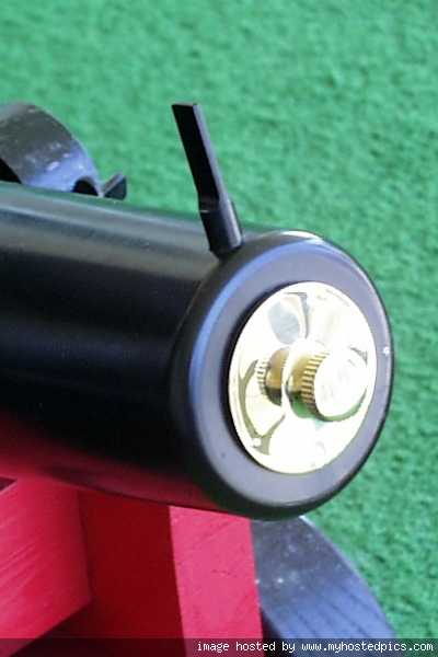

Well the strange looks at lowes finally paid off! (something about a guy on a mobility scooter with long white hair & beard measuring everything in sight with a set of dial calipers, I guess) ;D
But with my cannon on the porch I wanted a tampion in the muzzle! (to keep out "things")
But I found it!
It's a  solid brass sink stopper(well part of one, and I epoxyed it to a 1" pvc cap (1.687 bore cannon) It even comes with a neoprene gasket to make sure those eagles & two by fours don't get in there!
I think it looks great against Wes's work!
Dave

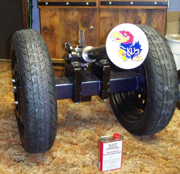

« Reply #13 on: September 05, 2008, 11:28:42 AM »
Go JHawk
Re: My new tampion
« Reply #14 on: September 05, 2008, 02:04:35 PM »
Jayhawk Tampion!!! Neat!!!
