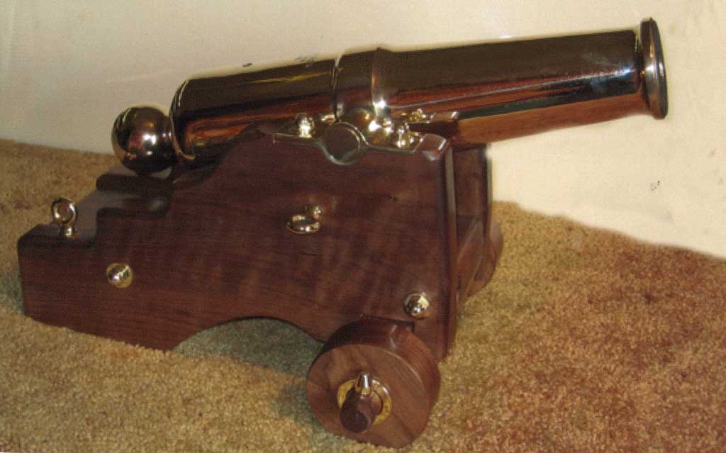

Offline Powder keg
  • Posts: 752
Re: 8 Gauge breech loading signal cannon (dial up users Beware)
« Reply #87 on: October 05, 2006, 05:56:20 PM »
Well got her done ;D Here are a couple pictures. I wanted to get some nice pictures outside but it's rained the last few days.
Wesley P.
"Powder Keg"
