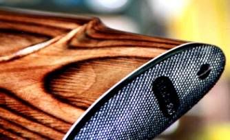

The rifle has a temorary scope 4x12 Bushnell. Will use it for testing. Have not yet decided on a final scope 4x16 or 6x24 Sightron.
Should get it shooting in a week or so.
1000 little things to do yet. Top is the 257 Roberts,
The 6x47on the bottom.
The 6x47 will tip the scale at 8 lbs when finished. So far so good, I hope it will shoot????? The bore looks really good too.
Fred M.

« Reply #1 on: January 15, 2006, 08:29:48 PM »
That's a real sweety, Fred!!! Great work!!! :grin:

« Reply #2 on: January 15, 2006, 11:40:10 PM »
you do nice work fred top looking guns.

« Reply #3 on: January 16, 2006, 12:45:27 AM »
Very nice looking pair you have there Fred. I hope they shoot as good as they look.

Fred how hard was it to do the stocks? Thoughs have to be the nicest stocks I have ever seen on a H&R

« Reply #26 on: January 24, 2006, 06:49:50 PM »
Saloon Slug.
Can't really tell whether it is hard to do. I just keep whittling away at it until it looks like what I consider a pleasing shape. My friend does the checkering. I used to do checkkering too but I can't see well enough for close work.
Try a piece of 2x6 soft wood and find out what you can come up with. Don't waste a good piece of wood until you sure you can do it.
THe H&R laminated stockes have lots of wood to carve away it takes time and patience. The finish is easy spray on Birchwood Casy two three coates is all it takes.
A two piece fancy grain walnut would be a real stock but the Handi is not somerthing to put a $600 piece of wood on. See if I can round up a couple of detail pictures.
Fred M.
