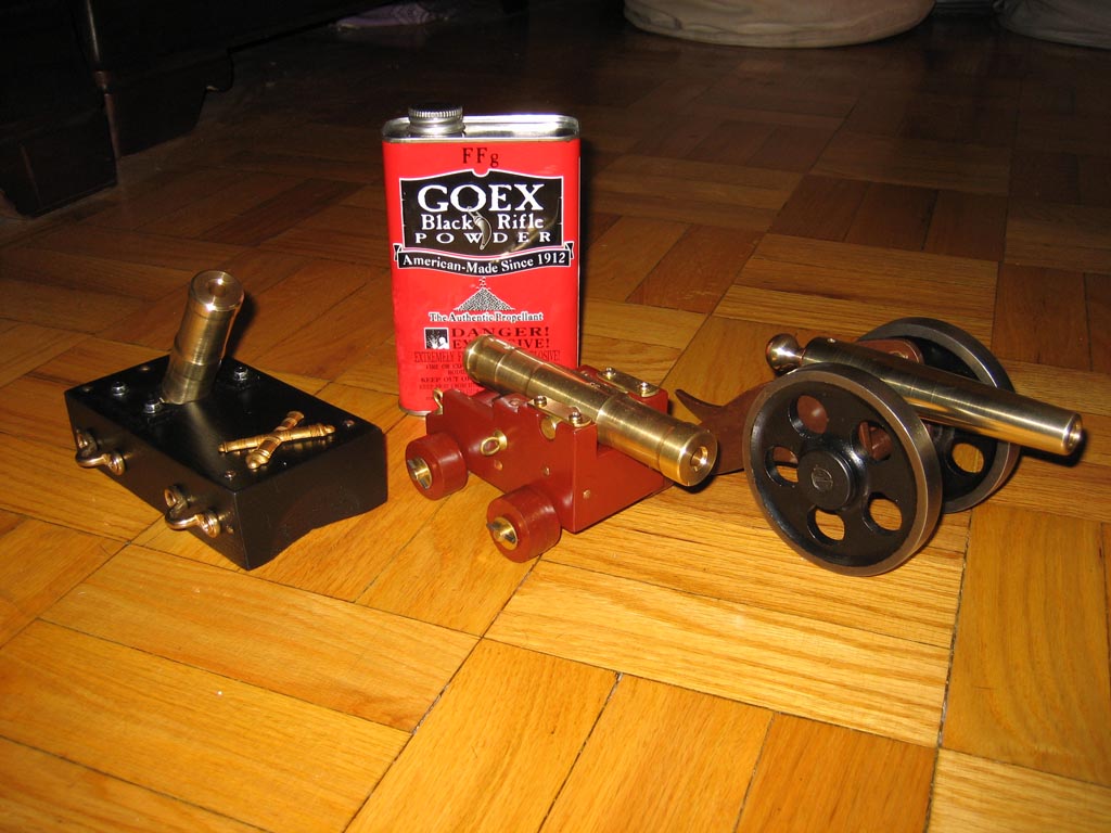

This was a fast turn around., to get a 4th of July mini-mortar., for firing in the city limits.., I was unable to fly beer cans in town  ::)  Anyway Brooks USA said they would get it here in time and they did. We had a lot of fun with it. for now it is on my desk-top .,lookin cool and holding 4 pens !!!     ;D      ;D       ;D      ;D       ;D       ;D       ;D       ;D       ;D

Hi Tropico,
Nice Mortar what size Barrel is that. Could send me the drawings for that mount. I also really like the look on your 1" naval carriage. Oh by the way who did you do business with over at Brooks from my understanding Michael has been really ill.

The size of the mortar is Brooks USA's largest dictator., it is the 1" bore. This would be 4 1/2 in length and 2 3/4 in diameter with 1" x 1' trunnions. I believe Michael has not been feeling well ., thats true. I had to wait a bit for my mortar however they responded right away and let me know about Michael and asked me if I wanted it.  For me I thought it would be worth it....., and it was.  Would I do it again..., YES., in a heartbeat.. They communicate very well. I recieved some correspondeance from JB and Michael.
About the Design ., Its just out of my head.,from I see in internet black and white photos  but my cardboard cut out I made is still on the table saw and you could have it., or I could scan it ., it is 3/4 oak ., just 3 pieces ., (2 sides and a floor) PM if need be.
Rich

More backyard "Poppin" . I was pretty excited about this new little cannon to add to my 1 inch artillery. I am having so much fun with this size.,its so compact and and yet romps a pretty good thump. The cannon came from ebay and then I cleaned it up after an inspect. Then of course the Brooks USA 1" Dictator. Its so cool to make up a bunch of pre-load foil charges that are usable with several guns. It really makes loading fast and enjoyable. The best part is so far all the foil is blown clear after each inspect. The vents are all scraping the very back of the barrel and I believe I am literally scraping the foil open top to bottom across the breach. I havent had to worm once.
