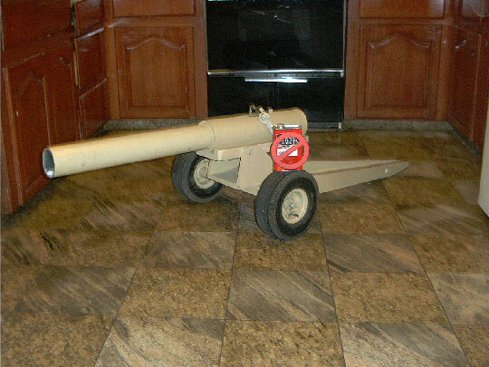

Here is a carbide cannon I built, functionally similar to the bird scarers.  The tube is CPVC, 4" nominal at the breech and 3" at the muzzle.  I had to shim it about 3/32" to fit the two pieces together.  The carriage is wood.  On top is a gizmo I worked up from a Coleman lantern lighter, the flint-wheel kind.  I think I will change it to the propane barbecue, piezoelectric type of igniter if I ever get a round Tuit.  I put about a quart of water in it, then open a threaded plug on top and dump in 40 grains of calcium carbide.  After screwing the plug back in and cocking the igniter, I just give the lanyard a tug, and boom!  It is actually louder and deeper than my 1" BP guns.  All the dogs in the neighborhood start barking.  It is safer, too, since nothing comes out of the muzzle but burning acetylene and noise.  I believe if I tried to shoot anything out of it (potatoes, turnips, hamsters) it would eventually rupture.  I think a sched. 40 steel or aluminum pipe would be plenty strong for shooting projectiles.  I got the carbide online for about $12 a pound, which is a lot of shots.  The gun cost me nothing to build, since I was able to scrounge all the materials.

I don't think my wife would let me keep that in the kitchen. Nice. MIKE

That is nice.  If you get a chance I would like to see some more pics.  I had thought about building a carbide cannon larger than my "Big Bang"  I agree about carbide/acetylene being loud and safe when propery used.  Big Bang has a long reputation of safety.
Everything with a tripod, wheels or a sled have been banned from the upstairs except the Jukars and Traditions scale models.  They have have not gotten grease or powder residue on the floor and are light enough to move to vacuum. She actually likes them.
TWO COMMENTS:
A word about SAFETY:  There is a point where PVC pipe will fracture.  The pieces have shapish edges.  Thre are many documented instances on the internet.  Agreed, it happens more often with the potato guns.
This gun looks like FUN.  But this forum is on BLACKPOWDER mortars and cannons.  A little OT (off topic) is OK.  ....
Point(s) taken.  I neglected to point out that the breech end is sched. 80.  Also, I use a long lanyard and clear the area by 30' before firing.
Sorry about the OT, but it was my best answer to the gentleman's question.  I will be more circumspect in the future.  May I at least point out, CW, that I wasn't the one who brought up flammable gas cannons?  Also, anvil launching is a bit farther afield than carbide cannons, IMHO.

Re: Loud salute.
« Reply #19 on: December 03, 2006, 06:52:05 AM »
No problems here.  A little OT   IS   OK.
Besides, it's not everyone who keeps a cannon in their kitchen!
You are just fine we just didn't want the topic to drift to far.
Tim and I do our best to keep thing focused and try to nudge things back in line.  This is often the case when we get new people here.
Carbide cannons, shotgun blank signal cannons and firecracker cannons as well as thunder mugs and anvil shooting are all things with in the purvey of this forum.  The modern exotic stuff isn't.
I will give you this yours is the largest Carbide cannon I have seen.
