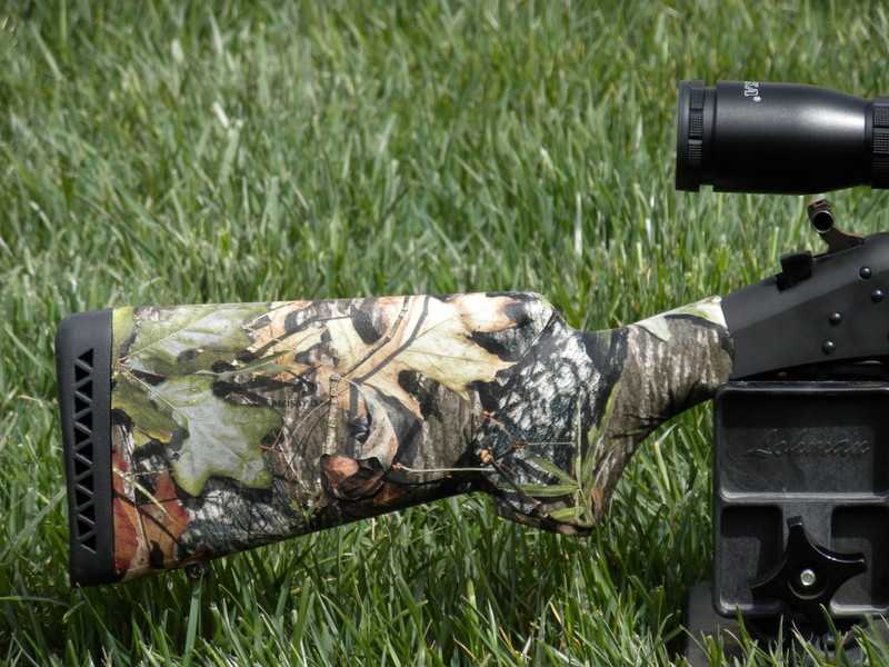

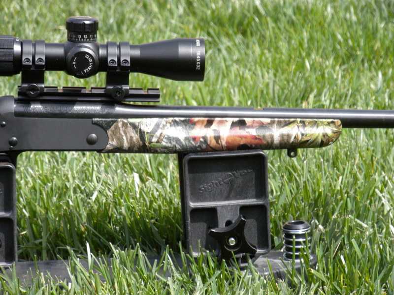

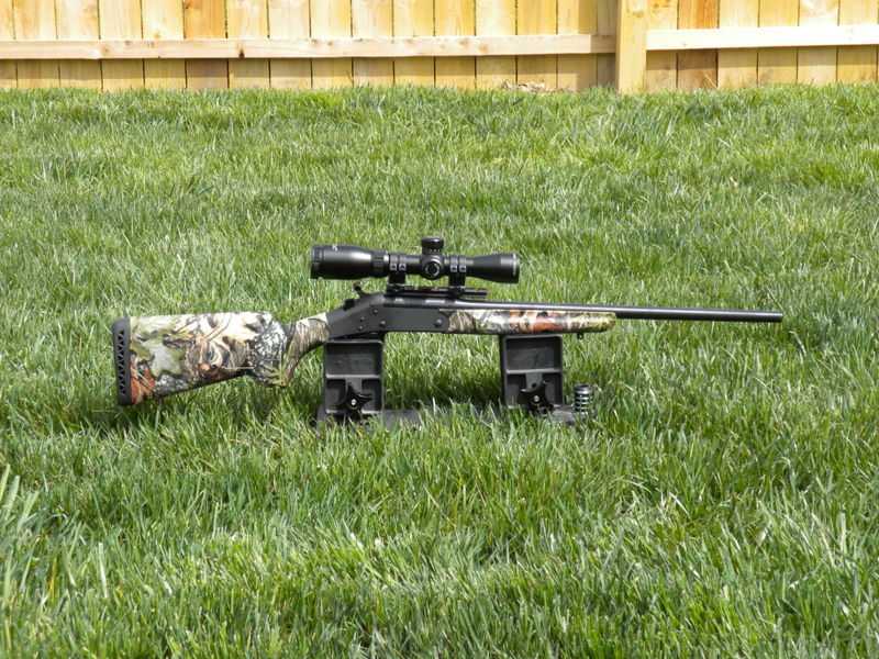

I've never cared for the plain black synthetic stocks.  I'm too cheap to have one dipped and I wasn't sure I would be satisfied with a paint job.  I found the Mossy Oak gun skin (this one is Obsession) and bought it off Amazon for $23.  The kit is for the whole gun but I only wanted it for the stock set.  All you need is a heat gun (mine came from Harbor Freight $8), sharp pair of scissors, and an exacto knife or new razor blade.  There's a 10 minute video on their site on how to put the skin on.
The skin is a little slicker than the plain stock but you can still feel the texture.  There are a few places it wrinkled but I expected that.  There is a seam on the stock I think I could have avoided if I'd matched up the two stock pieces so the pattern was closer before I started.  I also learned you need to get all the skin out of the sling post holes otherwise the skin binds when you put them in.  On the next one I will not do the spacer again, it was a pain.  I'll cut it off so it looks like a spacer on a wood forearm.
I'm very happy with the results.  An hour well spent on a Sunday afternoon. :)

Looks good, let us know how durable it is.   ;)

Looks real good. Nice way to spruce up the plain black synthetic. From your pics it looks like it came from the factory like that to me.
