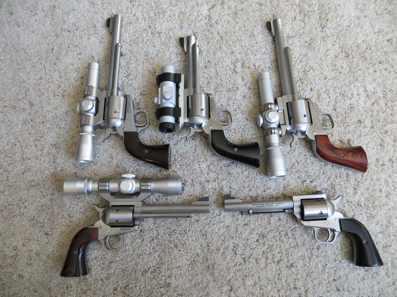

Congrats on the .475 Rich! I'm not doing well with irons anymore either and it's a shame to have such an accurate revolver and not be able to do it justice. Here is a pic that may give you an idea of which way you might want to go. The Mod 83's on top from the left are Lovell, Weigand with  30mm Weigand rings and an UltraDot and Leupold with Leupold rings. I think the Weigand base is out of production now but it is similar to the T'Sob. The 97's wear a Lovell and the .44 spl on the right has the ONeill front sight blade which is a big improvement over a ramp sight for me.
 In my opinion the Lovell is the best looking but as Paul pointed out the T'Sob gives you the most options. The Leupold is the most economical and I've had no problems with it even with full power loads. Hope this helps.
