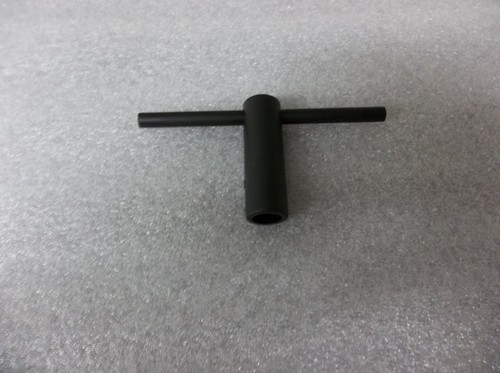

This won't help Winter Hawk, but If some user orders one and leaves it with the reamer when they return it there wouldn't be a problem any more.
$20.00
http://www.ebay.com/itm/120835923895?ssPageName=STRK:MEWNX:IT&_trksid=p3984.m1439.l2649#ht_500wt_1202
"This is a t-handle for hand turning chamber reamers.  It accepts standard 7/16" shanked reamers."
Is that the right size Tim?
