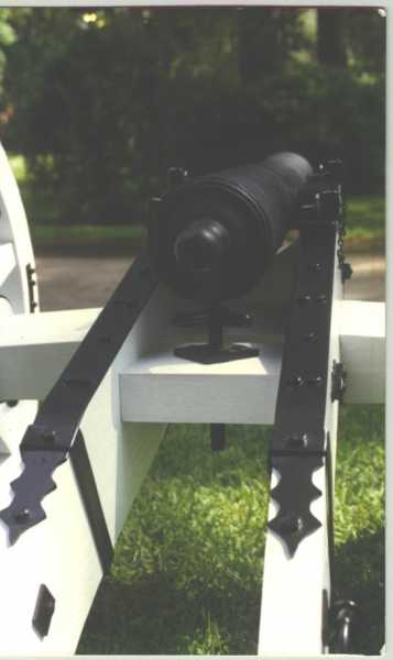

Ok here's pics...the barrel first, the split trail carriage in construction second.  The cross piece under the trail is only for my visualization of an axle tree.  Everything is oak; hardware will be stripped and blackened.  I am buying trunnion straps from Armorer 77 to match.  The pics will come when I do something significant.  18 1/2 inch by 1.5 wooden wheels planned. Thanks for looking.  Jeff G

Ok, update!  I added some of the iron furniture to the trail cheeks. I made a concession and used hex headed lag bolts.  I will sand off the letters on the bolt heads, and everything will be black.  The wood will be a grey-blue.
 I recieved my wheels, 18.5x1.5 wide. The crossbeam is the piece of wood that will utimately become my axle tree.
Thanks for looking, JeffG

What are you going to use for a barrel leveling devise?
I used a threaded rod for mine.  Where did you get the wheels?

The trunnion irons should be continuous from front to rear so the recoil is applied to the front of the cheeks instead of the rear of the trunnion notch.

Here's where the wheels came from:http://www.accentsofcountry.com/wagonwheels
I am thinking of re-doing the trunnion irons...and the lags, thanks for the comments.
The leveller is going to be hand fabricated, and attatched to a ring below the cascabel.

You could use the cap squares you have for trunnion plate sockets. Cut the cap squares to fit your plates, weld, then fit the plates to the cheek pieces. Then buy another set of cap squares with longer arms to fit the existing bolt holes.

It looks like you've got a good start on a classic 'double bracket' carriage, Jeff. Please keep posting pics of your progress.
