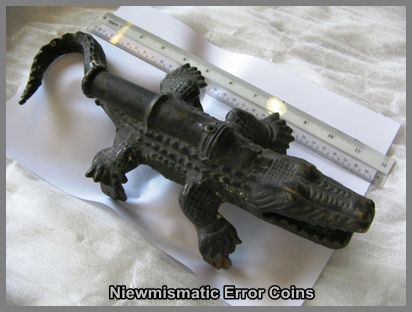

When I ran across this I thought of you ;D . Now this would be a fun project! Here is a pic and the link to their website...................
Dewayne
http://dniewcollectors.blogspot.com/2012/11/brunei-cannon.html
