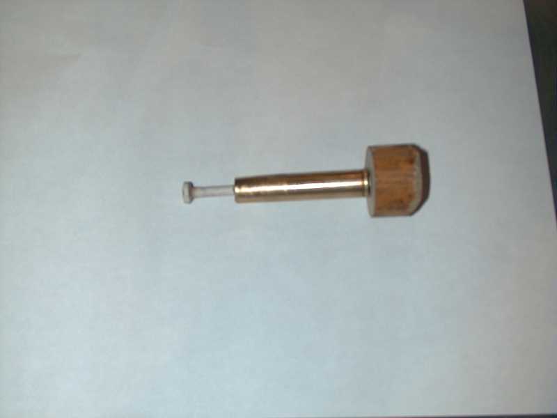

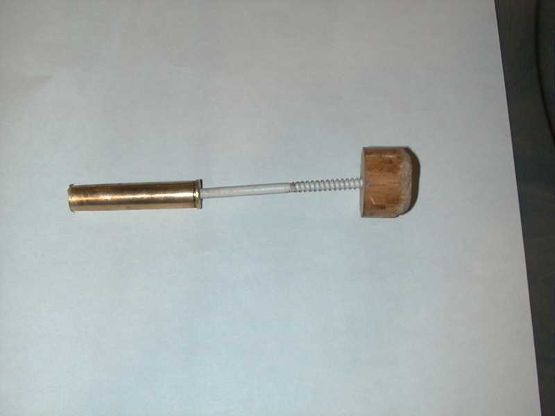

I have problems with pushing the bullets through the pan lube.  It's ok for a few, then the fingers get sore.  I had a cake cutter for .30 cal way back when and it worked ok.  I was working at pushing bullets through the pan lube and figured there had to be a better way, like the cake cutter.  I was working with bullets for a 40-65, and I thought of making a cutter for the bullets.  I used a 444 case (I am stingy with the 40-65 cases) kept necking it down through the 40-65 die until the neck would just clear the cast bullet, then drilled the primer pocket out.  Ran a long screw from the inside and screwed into a piece of wood.  I just push the shell down to the bottom, pull the bullet out, then push it out.  I know it is not fancy or pretty, but it works pretty well and it saves my fingers.

Pat  I have made several cutters like yours. If you shorten up the rod so that the head comes almost to the end of the case but stays inside it would be easier to use.

Bilmac, I looked around for a shorter screw, but despite all the junk in my shop, that is the only one long enough that I could find at the time.  I have been meaning to change it, never think of it until it is time to take the bullets out of the lube, and then I don't feel like going to the trouble of looking for the right screw.....
