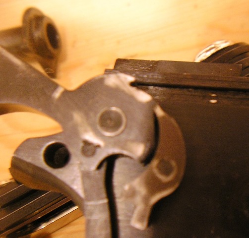

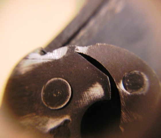

Re: OK---I GOT THIS HERE NORINCO
« Reply #55 on: January 24, 2010, 07:03:53 AM »
I am hoping that it will smooth out the trigger---there seems to be a small catch in it--otherwise it is back to Ed. Nothing bad and I suspect it will smooth out and I could live with it but---you know anal people.
Blessings
When I fixed the trigger on my Norinco I found the hammer had a scratch straight across, but its fairly easy to stone the hammer, just make sure you get a 90 degree angle.
If you want to work on the sear youll need a sear-jig to get the angles right.
You can place the hammer and sear on the outside of the frame to see and feel how they interact, use a good magnification glass.
