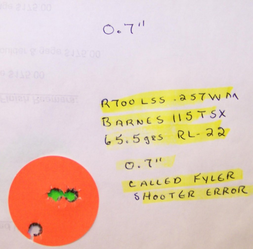

Now on to the really bright side of this review which is the .257” 115 TSX.
I have a limited edition Remington 700 LSS in .257 Whby magnum made only one year which I am also doing a review on. Barnes gave me a variety of their bullets to try in this one and the first load right out of the chute seems to be real close to a winner for me. The rifle wears a Leupold VX-II 3-9 scope.
That load uses Weatherby headstamp brass made by Norma with Reloader 22 powder and the 115 TSX loaded to an overall length of 3.160” which is what Barnes recommends in their newest manual. I loaded up three rounds each with three different powder charge levels those being 65.0, 66.0 and 67.0 grains. That last one is pushing right up against maximum in the Barnes manual but bolt lift was no different than with the others and primers look no different. I am not one who believes you can judge safe pressures from such observations but still the load is within book limits and exhibits no signs different than lighter loads so I don’t think it’s gonna be too hot for use in this rifle at least not in milder fall temperatures.
Both of the two lighter charges turned in an identical performance of 0.9” for three shots at 100 yards. Each bullet in each group was darn near equal distance from each other in a near perfect equilateral triangle. To me that indicates no bedding problems with the gun and a load with some potential to do better once I determine what exact load it wants and what seating depth the rifle prefers with this bullet. I do believe I will find a really sweet spot with this bullet and powder that will get my groups down closer to a half inch and who knows maybe even reach that small group size. For really long range work and that really is what I bought this rifle to give a try I’d like to see 100 yard groups in the half to three quarters of an inch range though normally I consider any load that consistently shoots under an inch fine for my normal hunting.
Still I didn’t exactly buy this rifle for my normal hunting. I am hoping to take it west to give it a try on Pronghorn antelope and perhaps mule deer at some point in the future. Both can turn out to be long range propositions and given my health and lack of walking ability these days sneaking close as I prefer just might not be possible for me. I’m clearly and vocally not a fan of long distance shooting at game but I do plan to do some long range practicing with this rifle once I find a truly accurate load and see if I can push my confidence level to at least 400 yards from the current confidence level of around 300 yards that I generally call my personal maximum shot range. Hey if I can hit prairie dogs at 400-500 yards I should be able to hit a pronghorn hopefully at least that’s the plan for now.
The higher charge of 67.0 grains clearly had more noticeable recoil than the two lighter loads and while it wasn’t bad and in fact is less than a .30-06 rifle of similar weight it was noticeable in this higher charge weight whereas I was not able to tell a difference between 65.0 and 66.0 grains. That charge also didn’t shoot so well turning in a three shot group of 1.7” almost double that of the two lighter charges. So I’ll be working this one a lot more using the two lighter charges and perhaps also trying half grain increments below and above each. I will also vary seating dept by 0.010” at a time both shorter and longer and see if I can find the sweet spot with this bullet. I do believe it is going to work very well with this rifle.
I must confess to being happy to have finally found an accurate load with a Barnes bullet as I’ve given them a try in a lot of rifles and a few handguns in the past using the original X bullets with decided lack of success. Groups in the past for me have been more like the .223” 53 TSX load with AA2460 and so I’ve mostly not reported my findings as I hate to report really negative results when I ask for the product for a test. I do tend to talk about it when asked but seldom report such dismal results. This bullet and rifle combination are the brightest spot for me yet with Barnes bullets and I do have high hopes the new TSX bullets are going to be a turning point for me with Barnes bullets.
I’ve shot this rifle so far with a few other loads both factory and my hand loads and can say that this Barnes bullet so far is the best shooting bullet in this rifle of those tested so far. That really is high praise considering the other bullets tried so far which have a proven reputation for accuracy. Still I’ve only barely begun to shoot this rifle and I doubt it has more than 40 rounds down the barrel so far so I fully expect it to continue to get better as I shoot it.
More will follow as more shooting is done with the Barnes bullets I have on hand. So far they are looking like they will shoot well and as such will get some time on game once I work out my loads with them in several rifles.

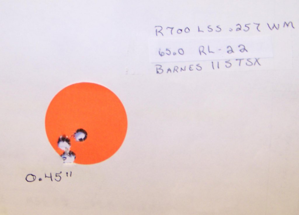

First follow up to my review:
I’ve now done some more firing with the Remington 700 LSS in .257 Whby magnum and must say that rifle loves those Barnes 115 TSX bullets. It is shooting them like a varmint rifle should shoot and making me mighty happy with both the rifle and the bullets. They aren’t the only bullets it’s shooting well but are the subject of this review.
I shot the rifle again today (11-03-09) using two loads. First was 65.0 grains of RL-22 with the 115 TSX and that load put three shots into 0.45” at 100 yards folks that’s varmint level accuracy from a magnum big game rifle. NICE! Next up I shot 65.5 grains of RL-22 with the same bullet. This group SHOULD have been better and it was strictly my fault it was not. I called shot number two a flyer as soon as it went off as I jerked just as I fired and knew it was not going to be with the group. It wasn’t but it only opened the group to 0.7” which is still darn fine for a big game hunting rifle. The other pair were kissing. I won’t say they over lapped but I find no gap at all between them. That group too would have been around a half inch or less had I not pulled the shot. That is not the fault of the gun, load or bullet but strictly a shooter error NOT the only such error made today.
