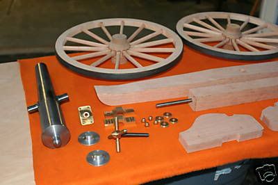

Normally I patranize sponsore of Greybeards, But on E-bay I found a deal I couln't pass up. It is a parrot cannon kit. That listed for $449, But I gave an offer of $400 which wa accepted. The demensions are 16 inch barrel with a 3/4 inch bore. Wheels are 16 inches in diameter and are dished. overall length is 29 inches, Long. The only issues are the trunion caps are not proper.. And it appears to be missing some hardware especially on the trail of the carraige. The goal on this is to make it as authentic as possible. Which also means painting the carraige and the hardware. The Irishamn is supposed to cut me a brass Parrot barrel that one I will keep the wood natural and add brass fittings. But this one I want to make authentic. I am wondering if anyone can post some pics of parrot guns that show some detail. As for the $400 hundred dollar price I dont think that is to bad because on "cannon manic" (I changed the name because alot of people got ripped off by this vendor). they had a smaller napolien for for over $600 . But it was more detailed.

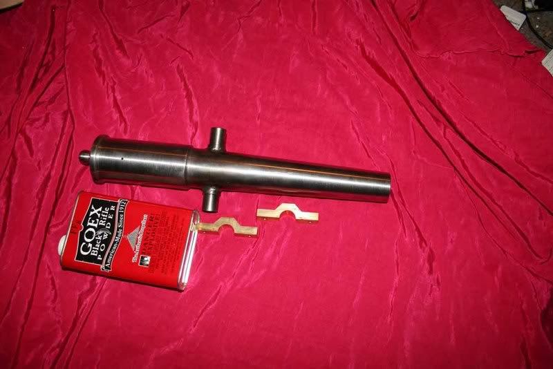

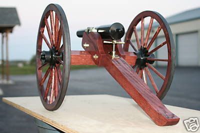

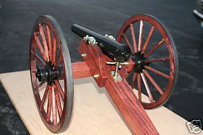

The cannon barrel on the brown carriage appears to be painted gold.  It isn't any cannon shape I'm familiar with.  Repro?.
Offline rays89
  • Posts: 266
Re: Ebay Parrot cannon kt and questions
« Reply #5 on: September 25, 2008, 04:34:39 AM »
The cannon doesn't have any markings on it. And it is painted to look like bronze which just doesn't cut it. Nothing looks as fine as a true Bronze or brasss cannon. This is starting to give me ideas on what to do with this Parrot gun. When I get it. Hmm
I wonder if it is a thin wall iron casting like I have seen in some parks.
« Reply #8 on: September 25, 2008, 01:33:01 PM »
And the barrel is not shaped like a Parrott.

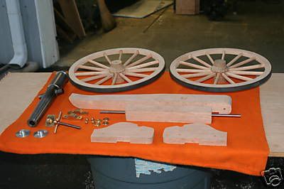

This cannon is supposed to represent a Revolutionary war cannon not a parrot gun Sorry thread is getting sidetracked. I did get the kit today but I did not have achance to check it out yet. I will post more later.

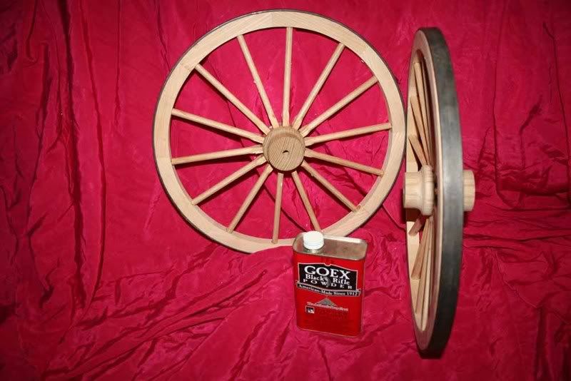

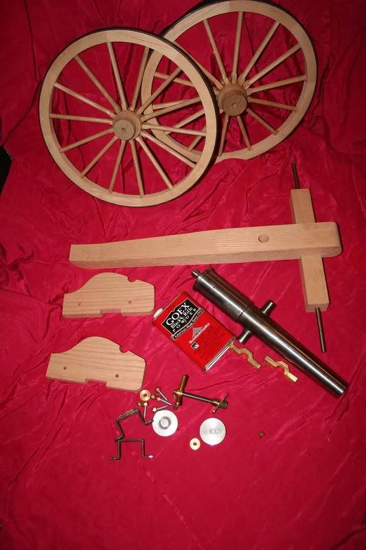

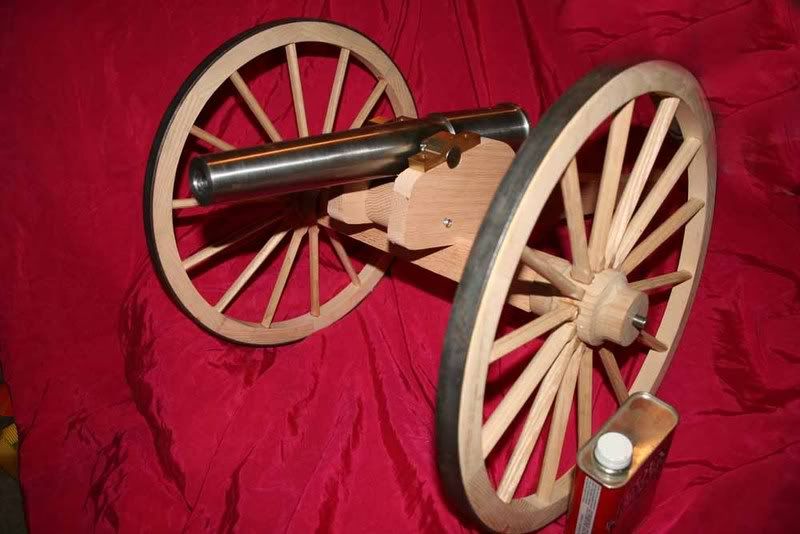

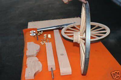

Well I have received the kit. What is noce the wheels are dished.This is a kit and for $00 is was a good price. The barrel is nice acept there are spot welding marks by the trunions. Here are some pics of the kit but  I do like that here are some pictures plus I did roughly put it together
Sure that Parrot gun never had a brass barrel but they were always painted like this
I do like the natural wood finish and brass barrels so I might do some radical changes. I have worked with a few of the fine sponsors from this board but I do know who I need to contact who specializes in this kind of work. And I know the finished product even though not authentic is definly going to be some serious eyecandy
                                                                           Ray

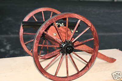

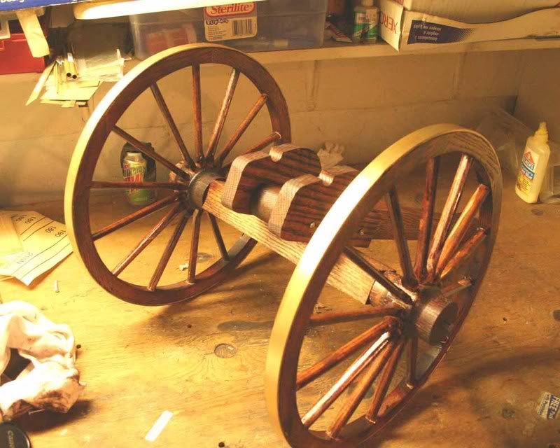

I figure I would show the progress of what I have done so far. I would say I am less than 50% complete on this project. The only complaint I have, Is the spokes by the hub have to much glue not allowing the stain to soak through Ugh. Hmm a stained Parrot gun. Doesn't look to scale to me. And hey this Maker is not a sponsor of Greybeard!!!! Well this is going to be an unusual parrot gun and yes a sponsor of Greybeard outdoors is giving me a hand on this project. More to follow.
                                                                                 Ray
Offline intoodeep
  • Posts: 776
« Reply #14 on: October 14, 2008, 03:51:43 PM »
rays89,
 It looks as if the wheels are on backwards (atleast the right one, when looking at the photo). They appear to "dish" outward instead of inward. I know that you are still in the building process but you may want to keep that in mind when you do the final assembly.  ;D

The wheel looks backward because of the picture. I am going to try the exacto knife bit to scrape the glue. But first I still have wipe the stain off I put to much oops.  DD my good ole friend yes there is no need to stain before painting. But as usual I am going to be a little different on this one. I am not going to paint it. Yes I know thats a "Crime"  While the original one pictured on top of the post is just stained.  I have plans on making this one look even more different. I am just waiting for some more parts. From one of our sponsors. More to come soon.
                         Ray

   Before you mentioned the excess dried glue on the wheels I was curious as to why the maker/seller had painted the naves and bottoms of the spokes black on the wheels of the carriage he posted photos of on eBay. I have also had a few problems with glue penetrating the wood I was working on and then preventing the wood from excepting the stain I tried to apply. I'm now working on a full bed naval carriage in mahogany that is almost completed and I used liquid hide glue on it. When I clamped the pieces together I used a cloth and very hot water to get all the overflow glue off the wood, but I evidently missed a very small section on the bottom of the bed. Well, I sanded the bottom of this carriage (and I mean sanded, there was no glue left on the surface of the wood) and this small section would still not accept the stain. This same problem has also happened to me when using epoxy as the adhesive on wood (with epoxy I use a cloth and acetone to remove any excess glue). In my experience with at least some types of glue, once the glue has penetrated the wood and dried, ( especially a porous wood like mahogony or plain sawn white oak) scraping or sanding hasn't worked to get the grain to accept the stain. I thought that with the hide glue maybe a steamer with suction might get the glue out of the grain but I don't have one so I couldn't try this. If anyone with experience in woodworking has a cure for this malady I'd love to learn about it.
