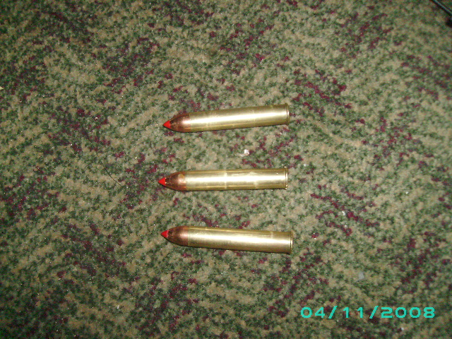

image hosting by [url
Yes I have tried 410 brass cases with 300 grain SST muzzleloader bullets. Today was my first live fire and they grouped 1" at 25 yards with a hasty rest on my gun case on the bench. I am using starting trapdoor data for my loading. I am not trying to invent a 45-70 as i have one of those, just a lower recoil more effective .410 slug for my daughter to use in slug season in southern MN.
