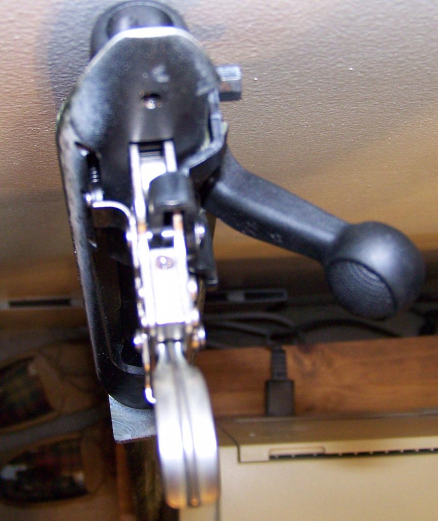

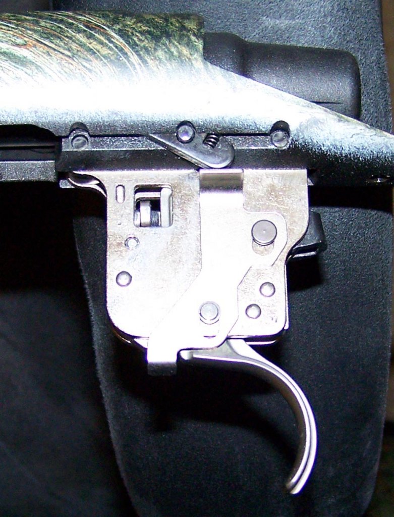

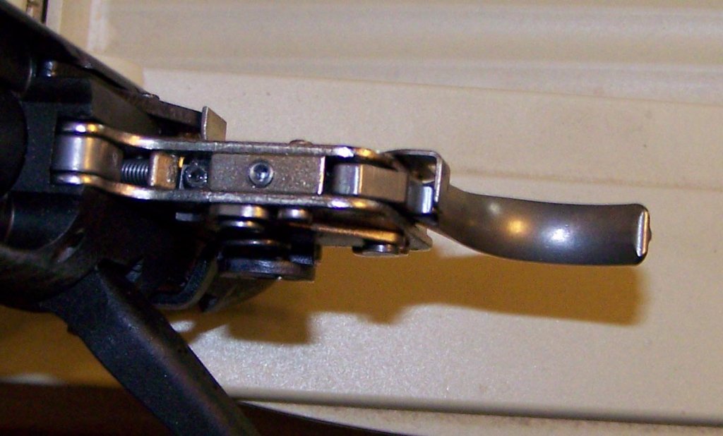

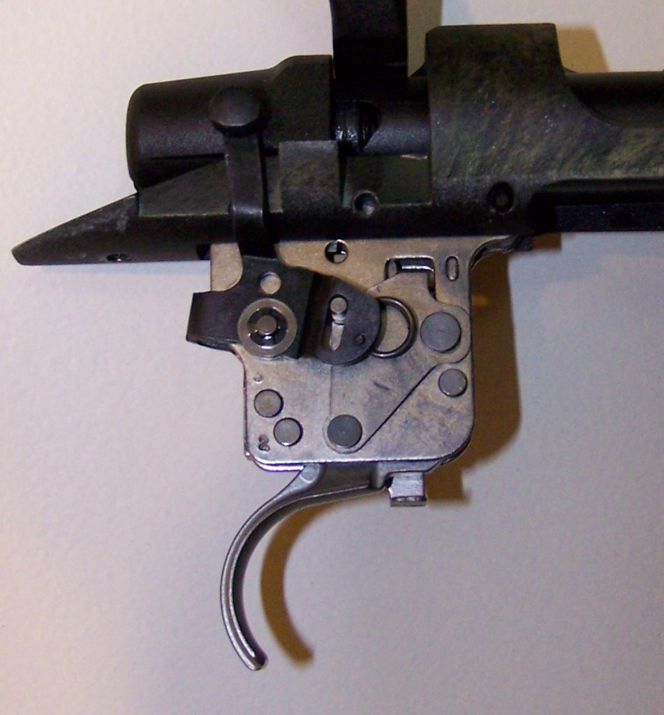

Here are some photos I took of the X-Mark Pro trigger assembly on my Remington Model Seven Predator today while adjusting the trigger.
And here are both rifles after working the triggers and adding the scopes.
