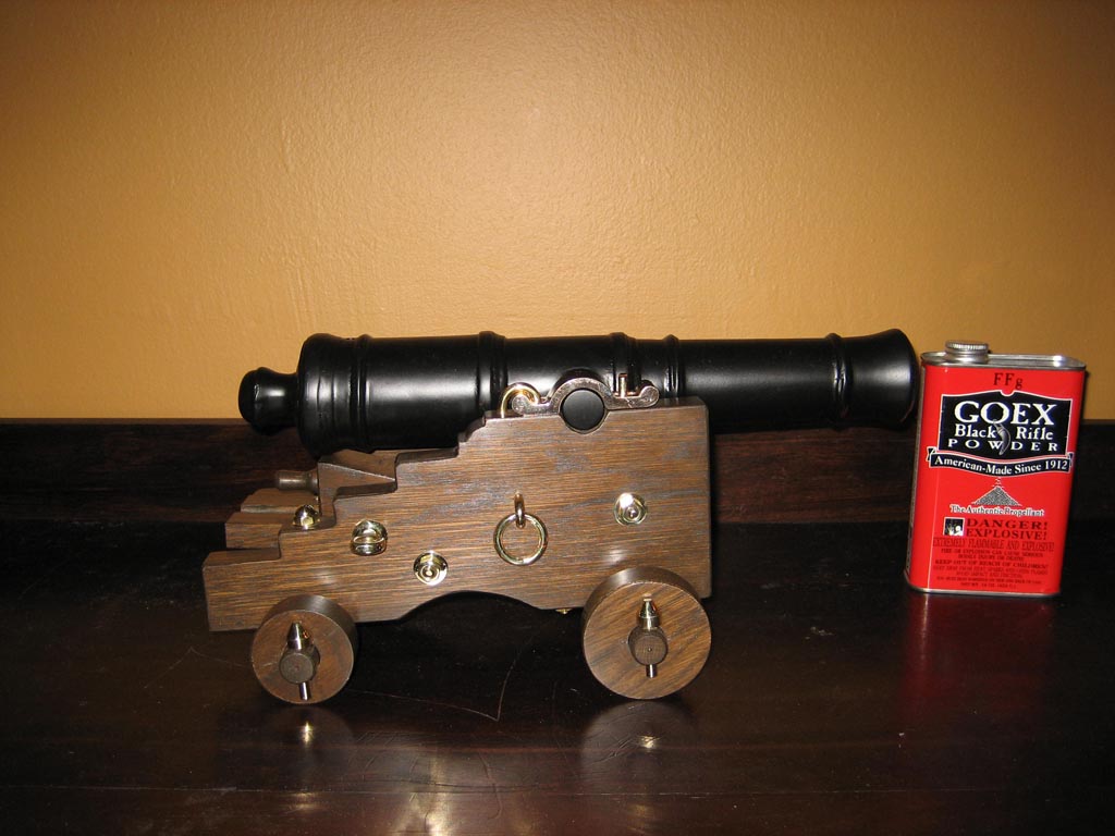

Hi DoubleD... I have flipped the quoin over and over and over and can't decide which way I like better.
Yes, I enlarged the truck axle holes in the back only so that they were elongated in the up and down direction. The "floor" is groved to accomodate the axle as well. While enlarging the holes with a 3/8 round file, I intentionally beveled the slot in the truck floor so that the axle would pivot in the middle. If I enlarged the truck side holes only, but it did not pivot in the middle, I think that one wheel would just hang limp. By bearing all the force in the center point of the axle, the axle gets all the weight and each wheel gets half of it. By applying the rear force in the middle of the axle I guess it sort of turns it into sort of a a "tripod" rather than a "quadrapod".
I'm glad to see that I am not the only one to run into this issue  ;)

I know the floor isn't exactly historically correct, although it is possibly closer than just a flat floor.
However, the complexity of what I see when I look at it is such that it looks like it must have been done that way on purpose, so I think it would pass casual observation by someone who hasn't a clue what he is looking at as being a historically correct design I am sure  ::)
The rear "floor" is at 5 degrees. The quoin I will have to doublecheck ... I am thinking something like 20 degrees, but I need to make sure before I commit to remembering that right. The quoin is still a little "slippery" under the pressure of the barrel. The still drying linseed oil may be part of that slipery equation. Maybe a few more floor degrees would have been better. Still, I am sure it is better than flat. If it was flat the quion would be shooing out like a greased pig.
When cutting the 5 degree angle on my compound miter saw, it was hard to keep both sides perfectly exact. I realized that being able to dial in "degrees" on a modern saw has it's drawbacks. I think the tolerance stackup is worse that just marking rise and run and cutting along the dotted line.
When I make the big carriage, too big for the compound miter saw, I will just mark rise/run in inches on the wood and rough cut with a skill saw, followed by chiseling the mortise finished. A table saw would be nice, but don't have one, and don't have the room for one.
I am thinking that measuring rise/run may be more accurate that dialing in an angle, measuring and starting at the correct starting point, and  then reversing the angle for the other side to do it a second time over there.

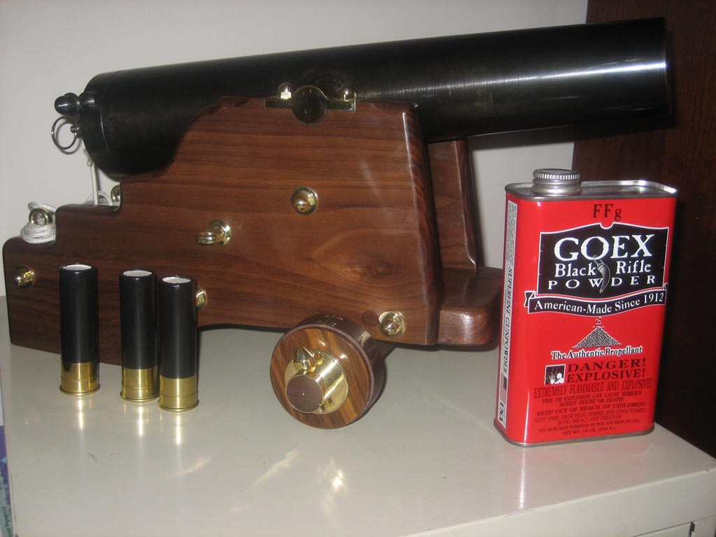

Here is a question for intodeep, and DD, and anyone else that has build a full sized naval gun.
When I put this brass gun together, using proportions that I believe are reasonably historically correct, I noticed something that had previously not occured to me as something that I think is built into the naval carriage design.
This completed gun weighs around 25#. It IS heavy. Yet, I can pick up the rear end with one finger with little effort to aim it. Is this unique to the one that I built, or is this a feature of the naval carriage in general? The center of gravity is releated to the trunnions being just to the rear of the front wheels and, well, every naval I have ever seen has the trunnions located there.
By coinicidence, I made the carriage stick out far enough in front of the front wheel that if I pick it up too far, the front bottom of the carriage hits ths grouond before it becomes top heavy and goes over nose first. This was totally by accident this time, but I have every intention of doing it on purpose for the 300# gun.

My 1/5 scale 24 pounder has a similar balance; just a little on the rear wheels.  It may be intentional so the gun can be traversed relatively easily since it would have to be done by prying on a ship's deck.  Remember that a full scale gun weighs on the order of 6000 lbs so the weight on the rear would still be substantial.
 While, I cannot say for certain that GGaskill's statement is correct it does make sense. Naval guns were used both on ships and land. When on ships the ships were always moving. So, I think engagement was more of a volume volley then it was accuracy. Now, with these being used on land such as a fort. They would need to reposition the guns for aiming.  Since, they have 4 straight wheels it is not as easy to turn them (as with a field piece) so, just a lift/pry and twist would do the trick.
 Since, what I have posted is purely hypothetical it would be interesting to know for sure.

intodeep, any idea how much force in pounds it takes to pick up the back of yours?

My Mdl. 1841 is a Full Size on a naval carriage. The barrel weighs 850lbs. My 'elevation'  weight  at the breach is maybe 15lbs. Dean
Rick,
 My guess is 40-45lbs. I even had the wife give it a go. ;D  She thinks the same. We only lifted it an 1" or 2".  Below is a photo of the area we lifted from. Hope this helps.

I am starting to thing that my accident was an intentional feature of the naval carriage.
Intodeep, an yours tip over if lifted too high or will the front of the carriage hit the ground first and stop it from going nose over?

Most of my naval carriages are short in the front . I believe that was to get plenty of forward length of barrel thru and past the ship and usually with the front wheels hitting the ship a little bit ahead of the carriage.   If the axle is moved forward even a little ...., that drastically changes  the weight distribution to make it much heavier in the breech.   I had 1 cannon carriage that the center of the front axle was in line with the trunnion...,and it would go nose down much much easier.., and the carriage would not catch it.
With the axle a little further  in front of the trunnion .,way  more stable ! ! ! the carriage wont catch it.....,  but it wont go forward over either.
 Rick,
 If mine was to do a header it would be the muzzle that hit the ground first. To be honest I have never seen a large naval gun take a nose dive. I think the only way it would happen is, improper handling or someone trying to sit on the end of the tube (don't ask, I was a kid).
 I know that even a field piece has the same balance issues (just a little higher center of gravity) and can even take a nose dive if not handled correctly (I know sounds crazy). I have personally moved around a 1/2 scale field piece and at times it feels like it wants to go over.
 I understand your concern for safety but, you are the best to make that call as it is your own design. We look forward to your final product.
