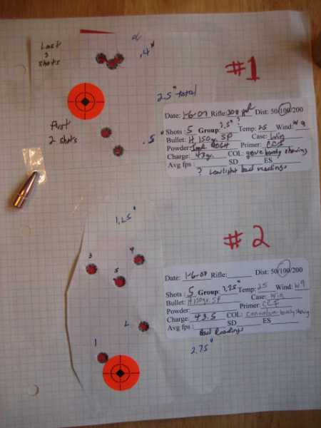

Back from a range session with my 308 Ultra. My second batch of reloads performed great. I am working up loads for Hornady 150gr SP, Nosler 150gr BT, and Nosler 125gr BT. Very fun. Initially I have simply seated the bullets to the standard over all length. I want to fine tune this however so I resized a blank case and cut slits in the neck. I was going to use this to tell me when I was on the lands. Well, much to my surprise, I am barely touching the lands with the bullet only about 1/16" in the case. I was going to very the gap to the lands from as low as .003 to .015 to see what work best with the charges that seem the most accurate. How much of the bullet needs to be in the case?
Inches make champions.

I appreciate the bullet and powder suggestions but it doesn't answer my question. With a single shot I am of course not concerned about bullets feeding through a magazine. Is there a minimum seating depth? Or can I seat these out as far as I can so long as I am off the lands? Secondly: Based on my range session yesterday I'm not so sure where the sweet spot is. At 100 yds On 2 successive strings in a ladder my first 2 shots were within 1/2" of each other, then on the next 3 shots the point of impact immeadiatly shifts up about 2 inches so the final 3 shots are within about 1/2" inch of each other. So do I have one 2 inch group or 2 half inch groups. I'll post pictures if I get a chance and I will not rehash all of the modifications and accurizing that I have done with my Ultra as I've already created a massive thread on those issues. (barrel bedding, lug shimming, pulling through, latch cleaning, pulling through on trigger, scope rail lapping and re-mounting, bore polishing ...), this is the third scope on the gun (started with cheap Simmons Master series which broke, then to new Nikon Monarch, then to almost new Nikon Prostaff)

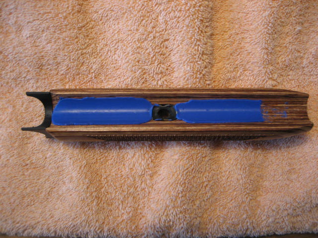

I never put a 10lb. weight on mine when doing the RTV bedding..Here's the last one I did...and how it turned out..
This is a side view..showing how far down I taped the forend..
This is a view looking into the channel showing how much I taped it...Yup...I used 3m blue painters tape this time instead of the electrical tape.
Here's the rifle sitting up curing over night..
Here's a finished view after removing the tape.
A little better view of the same..
The whole idea is to create a even gasket bed for the barrel to help dampen any vibrations and to float the barrel evenly..remember I sanded the fore end prior to applying the RTV gasket silicone ...By hanging a weight on the end of the barrel..you didn't do this and are basically adding additional torque to the barrel...You can do just the reverse as I have done..You can add the RTV to the foreend hanger slot...and build a pressure point 1/2" in from the muzzle end of the foreend..and see if yours will respond better that way to...ala the Weatherby style..I've had a lot of luck doing the way I've shown...While not making every rifle a tack driver...most of them have responded nicely..others became extreamly consistent wither  hot or cold...first or last shot all staying inside a 1" with the loads I use..factory or handloads mind you...
Hope the better pictures help explain it a little better..
Mac

Mac11700, that is a very neat example of bedding. Taking your time to prep it right is key. Because rtv is so soft, I doubt it was capable of inducing that much stress, but you never know. The good news is that rtv is so easy to remove. I would suggest rebedding without any weight on the forend and giving it a try. If no improvement, try a harder bedding compound like acraglass gel (they have one gun kits) or jb weld. If you do, be sure to put modeling clay in the gap around the screw lug where it meets the barrel so you don't get locked in, and use the release agent properly (don't forget the screw). Car wax works well. A harder bedding material helps maintain the forend position on the barrel better, especially when removing and replacing.

I've tried Acraglas in the manner you described to no avail...and it is a real pain to remove.The RTV provided much better results..clean up is a breeze..and removing it takes very little effort. I used the release agent provided with Brownells bedding kit as directed and had no problems removing the foreend after the RTV has set up and cured.It takes 2 good coats of the release agent to work properly..

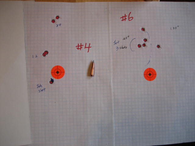

Wow, in the time it's taken me to get figure out how to post these pictures I could have bedded it already. Well here's a photo of my previous bedding and those madding groups I was talking about. All groups at 100 yds. Groups 1 and 2 were with Hornady 150gr sp. Groups #4 and 6 were Nosler BT 150 gr. The common thread amoung all the groups was that the POI shifted up after 2 shots. The wierd thing about group #4 is that the 5th shot was back down. I had no called fliers. #4 looks pretty good if you just take 2 shots at a time. Same with #1.

one more try to get the group photos
Yes I am closing and cleaning the latch forcefully. I even speak sternly to it at times. However, I will not that my new handloads did require a forceful closing or it would lock. I had no pop opens on my shots.

Yet another try with the groups

Sorry, I'm trying to do too much. I was trying to say that with my handloads I had to close it forcefully or it would not lock. I don't think I had my sizing dies as snug as at needed to be. But nothing pooped open and the latch is squeeky clean.
