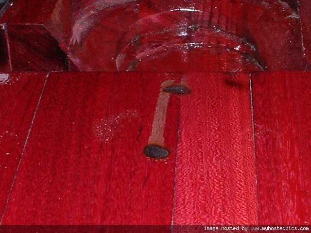

Damage. How do I prevent it?
« on: September 03, 2006, 06:47:01 PM »
I need ideas on preventing any further damage caused by fuses.
Re: Damage. How do I prevent it?
« Reply #1 on: September 03, 2006, 07:32:41 PM »
Lay a metal or sacrificial plate over the back of the mount where the burnt fuze falls.  If you make it L shaped, it will prevent the burning fuze remnants from being blown out to the rear.

That's what I figured I'd have to do, I was hoping there was a no cost trick I wasn't aware of.

I had the same problem with my first mortar.  I used the piece of foil to cover the base at first then gave up on it.  The burn marks give it character.

Shorten fuse.
Use quill.
enlarge vent.
Paint the bed.

I concur with Double D about using quills instead of fuse. They leave alot less residue on the bed.
Be sure to use a linstock to light the quill so that you are a ways away when it goes boom.

If you straighten the fuse, it will blow further away when it fires.  (Then you need to worry about fires 5 - 10 feet behind the mortar.)

freddo is on to something... a damp rag maybe?

Seriously wetting the base to prevent damage is not possible, the polyurathane is waterproof. Although I suppose a wet sponge setting there might work. Still a shield would be less hassle.

If you have a vent of the proper diameter, the fuse embers should blow clear.

Several guys said use a quill.  I concur as they are very fast and almost free.  Get coffee stirring straws from your neighborhood 7-11 or someplace similar.  Get 1/4 wide masking tape from a car painting supply shop.  make a long needle from a piece of wire longer than the straw and fasten  it to about 4 feet of the tape.  Coat the tape with 4f powder and slide the straws onto the tape using the wire needle.  Space the straws with about 1/2 " of tape between and cut them apart.  You will have over a dozen quills in a few minutes.  Light them with a linstock as they are very quick.

    It's just an opinion but it seems to me that GGaskill has offered the best solution. I just went back to the thread where you posted a full shot of your near finished mortar. You did a fine job on the bed. The angle or L shape wouldn't be necessary; just use a piece of sheet metal to cover the whole rear and half way or a quarter way up the sides of the top of the bed. All you would need to cut is a square in the middle of the front of the plate for the bottom of the mortar to fit through and two rectangles to fit around the cap-squares. You could use a sheet of cardboard as a template to get the exact measurements of the area you'd have to cut away. My cousin recently gave me a old brass kick guard from the bottom of a door, that he decided not to use. This plate has a decent thickness to it; it would be heavy enough to stick to the top of the bed when you fired the gun and the brass finish would look good combined with the natuarl red color of your wood. When your done firing the gun, remove the plate and your all set to display the mortar in your home.
