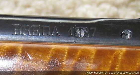

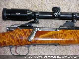

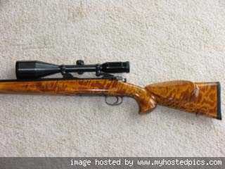

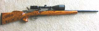

« on: September 06, 2006, 05:05:40 AM »
I just picked up a rifle in 6.5 X 55 and was wondering if anyone would share any reloads, which powders might be best.  Wish I knew more about the rifle.
bigboar
https://www.gboreloaded.com/mhp/images/bigboar/05_1.jpg
https://www.gboreloaded.com/mhp/images/bigboar/05_2.jpg
https://www.gboreloaded.com/mhp/images/bigboar/05_3.jpg
https://www.gboreloaded.com/mhp/images/bigboar/05.jpg
