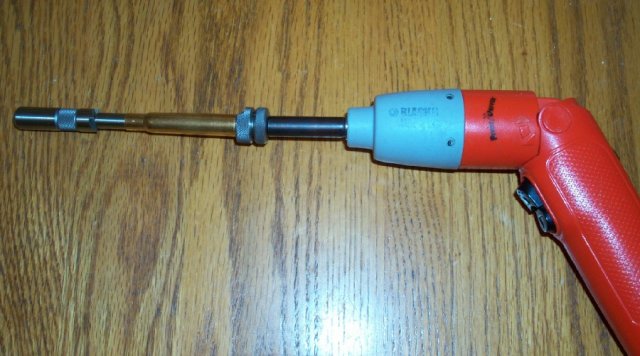

I made a little adapter out of an old 8-32 cleaning rod so I could chuck the RCBS brush in my cordless drill instead of using the handle, works like a champ for cleaning primer pockets!! ;)
I decap with a Lee Universal decapper, then tumble em, then they're nice and clean when the go thru the sizing die. ;D

Quick: I was just trying my cordless drill with the old Lee cleaner tool chucked in it but it was a bit awkward.  I hadn't thought of the decap, tumble, size routine.  That WOULD clear the flash holes.  I have thought of getting one of those little Lee or RCBS presses and the universal decap.
