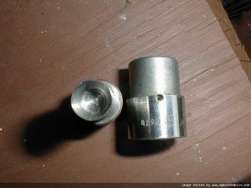

Mystery dies Pic I hope. Swag o matic??
« on: July 25, 2006, 03:58:52 PM »
I put this up as a new thread in case I blow the pic insertion.  here goes.  the die on it's side is the body.  the top punch is pointing up at the lens.  both dies have holes for locking set screws and both are marked CH  the top punch just fits inside the larger die and will slide in a bit but not far.  It is threaded on the other end to take a push rod I think.  here goes.
thanks for any help in id.
JB

Well it looks like about two dozen have looked at this and have had no hits.  Can any of you tell me if these are NOT for the Swag-o-matic?  I have a book that shows that press but I can not tell from the picture if it can tell these would fit it.  I do not think so.   These look like they fit into a sleev e that fits into a press.  I can't find much info on the products of the original CH company before the founder died, when it built almost everything...  Any historians in the members?  JB

Solved..... they are Swag-o-matic dies as per the original instruction manual I found at cast pics
http://www.castpics.net/RandD/swage_o_matic/swage_o_matic.htm
This shows them as I see them and it looks like I will need to hunt one down on ebay.  JB

JB,
That is the bottom set, do you have the top set too? I had to dig out mine to look at it, but that is what it goes to.

I guess I don't understand these dies.  They fit together and with the top punch inserted in the bottom piece and a jacket with lead core inserted from the bottom and compressed with a ram it looks like a fully formed bullet would be the result. You are saying there are other dies besides a sizer and top form?  I guess I have nothing and I don't understand the machine.

Greg, is what I have part D and F as show in the instruction sheet?  the other parts shown seem to be part of the press.  Please advise.
OK, Those parts (D and F) are the bottom section of the die, there is the top section of the die (A and B), the bullet is formed between them as it is squeezed under pressure. I hope that makes sense.

Isn't A and B a part of the Press, would you not change out the two die pieces and put others into the same support body and use the same support bolt.  I may have the B part from some other odd equipment I bought.  Does the bolt screw into the support body or just into the top punch and slide in the body.  the pic shows a long bolt with only the bottom 1/4 threaded.  Perhaps you can post some pics as well?  Thanks for your help.  JB

JB,
I will try to get the camera working at the house. The B die has that rod in it that has the nose shape of the bullet in it, but the B die is the top section, at least on mine I think. It has been awhile since I had it out, but I will get it out in the morning when I get home from work.
