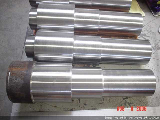

Well, I made a peice of scrap. So when you have lemons, I guess you make lemonade.
Do any of you fellows see a cannon here? The dimensions are 12" long, the big end is 4" and the small end is 2.700
I would love to make a cannon like George has been working on someday. The small end may be to small but I could make a ring to shrink on and make it bigger again. What do you think?
Michael

I can see a cannon with a 7/8 ths bore. That's a 2oz. cannonball, maybe even a 4 oz. ball.

What are the dimensions of the pieces?  They look like partially completed Brooke rifles.  I can send you a freelance drawing of one if you like.
Re: Is there a cannon in this peice of stock?
« Reply #3 on: August 08, 2006, 03:25:30 PM »
I see 4 cannons in a row, just waiting to be finished out!

George, the dimentions are, starting at the small end
Dia--2.700 X 5.150 long
Next Dia--3.025 X 2.750 long
Next Dia--4.00   X 4.800 long
Overall length is 12"   Material is 4130 prehard
Yes, they do resemble those Brooke rifles. I would like to see the drawing you have.
Cat, I've turned down eight of these. Should we build eight cannons?
Thanks fellows
Michael

I see a Widow Blakely
Scale this drawing up 1.4 times for direct scale or use Millwright/Gunsmith Desgin MIF techniques...Engineers could never figure out how John Browning desgined his guns using MIF. Browning made the guns first then the engineers came behind and drew them.  We have that backwards now.
For MIF with the turnings just as they are put a taper on the front two sections. You migh lengthen the midd'e section a bit and shortenthe breech section.  Make a cascabel,  Bore 1.33 add trunnions  and you have a Widow Blakely replica.
There is also at least one 8 inch siege howitzer in there  also.  Oh how about a Carronade and Daniel King Howitzer,  And surely there is at least one mortar.
If you can't see that in them, I'll furnish you an address of where you can ship them, becasue i see them.

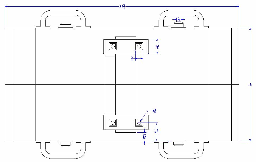

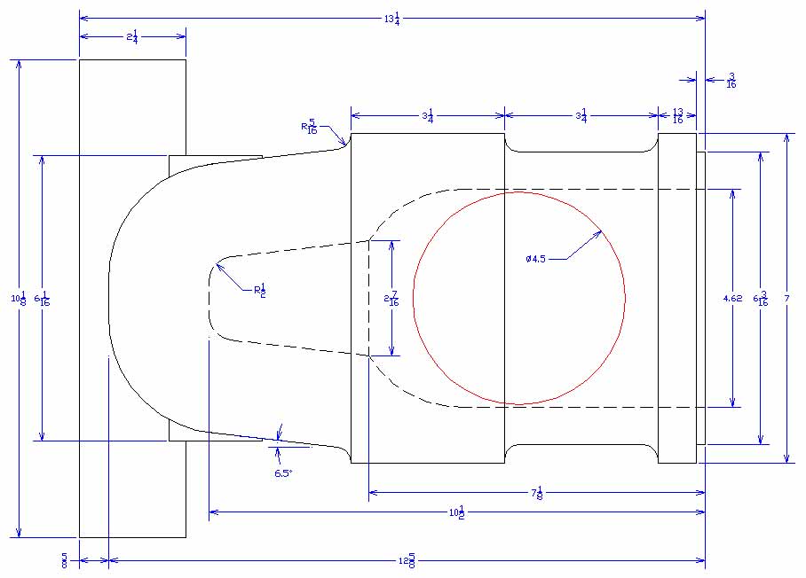

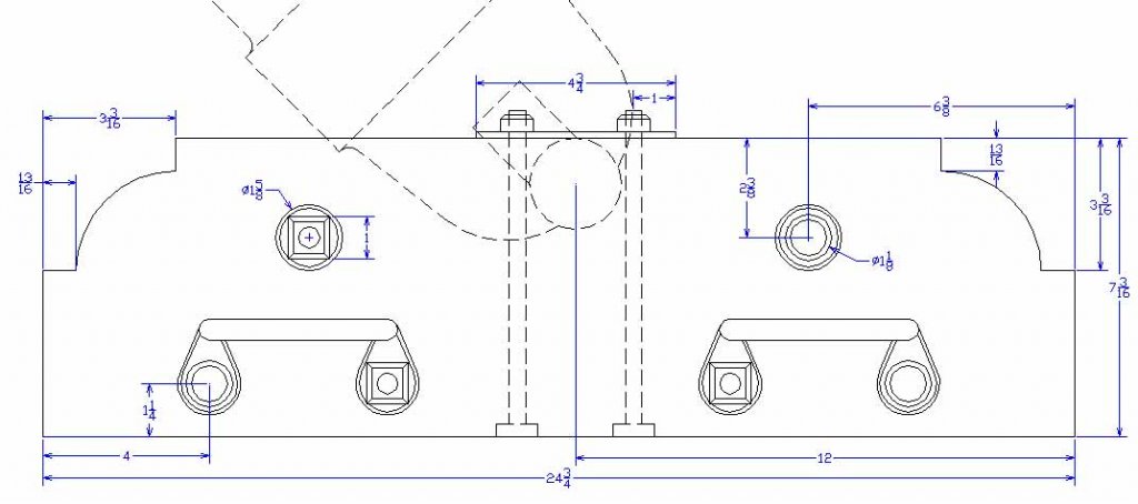

Here's two more in those pieces of iron.
8 inch howitzer
Carronade
