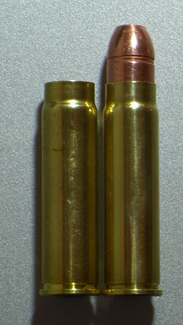

I have looked @ doing some things on the 460 and 500 S&W, but other projects have come first. I am thinking 460 S&W necked to .400 (on right on pic)or .410 should be great in an Encore (no need to push it to 65,000 psi though) I have also looked to neck the 500 S&W to .429 diameter (on left in pic) .
I think that there are others necking down the 500 S&W to .475 and .458 also.

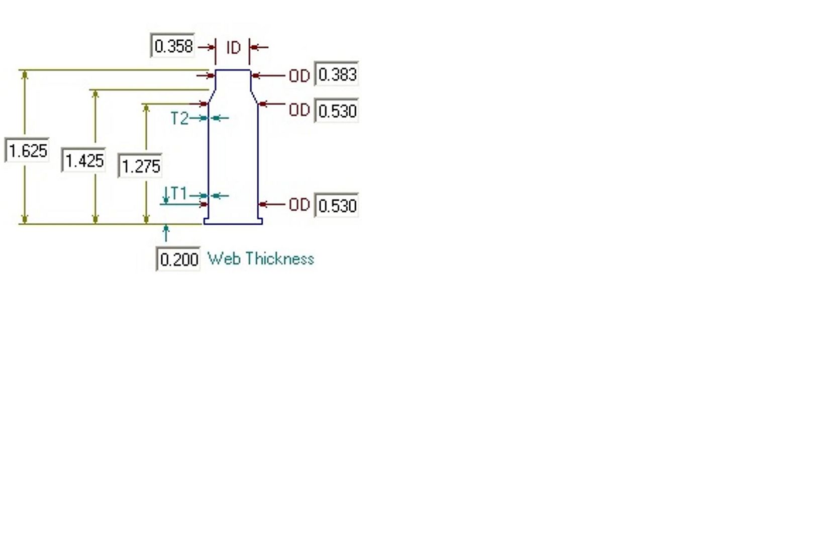

here is a drawing I did with Load from a disk 4.0;
I took the basic ideas from 357X44 BD and applied to 500 S&W, also went with .358 diameter for rifle bullets and could be changed to .357 if wanted. In this configuration you would look @ about 2420fps with a 180gr bullet with about 45,300psi in a 16.5" bbl. Could be fun, but there are other cartridges that will do that and more... That is the great thing about wildcatting, you build it because you want to.
Scott

Will that .2" neck support a 180 grain bullet or do you have to push it inside the case to make it stable? You are cutting into powder space when you have to seat the bullets deep and that would either reduce the powder capacity or raise pressures quickly. The round looks great for pistol bullets but the selection of rifle bullets goes from one at 150 grains, to two at 180 grains to 200, 220 and 250. You probably don't have the capacity for powder to push a 225 or 250 grain bullet - the 358 Winchester barel does that and the 35 Remington does a fair job up to 200 grain bullets but with the case as you make it I wouldn't think you could get more than 1900 fps with a 200 and maybe 1800 fps with the 220. That is about the lower limit for terminal performance with the 35 rifle bullets.
You have almost duplicated the 357 Herrett in volume and could probably make the two rounds identical in volume if one were to perform the AI treatment to the Herrett case straightening the case and making the shoulder a 40 degree angle and move it up just a bit. Your powder is more "square" in configuration and that might make it more accurate or consistant than the Herrett. Even if you are limited to 200 grain bullets there might be a niche to fill for a round between the 357 Maximum and the 35 Remington in a pistol case. With a 14 or 15 inch barrel it should be just about all the average shooter can handle comfortably. In an 18 inch carbine it would make a great little black bear and pig gun with either 180 or 200 grain bullets.
