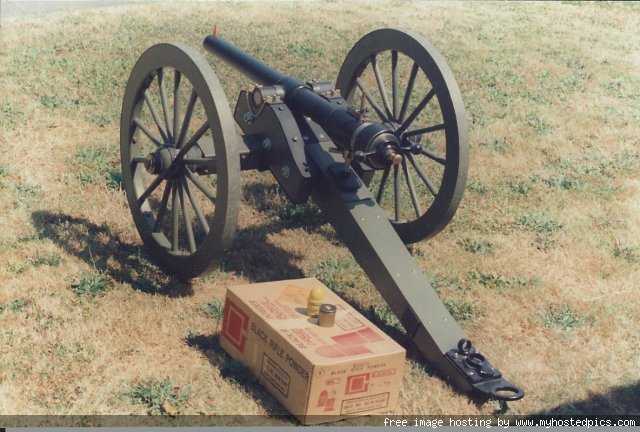

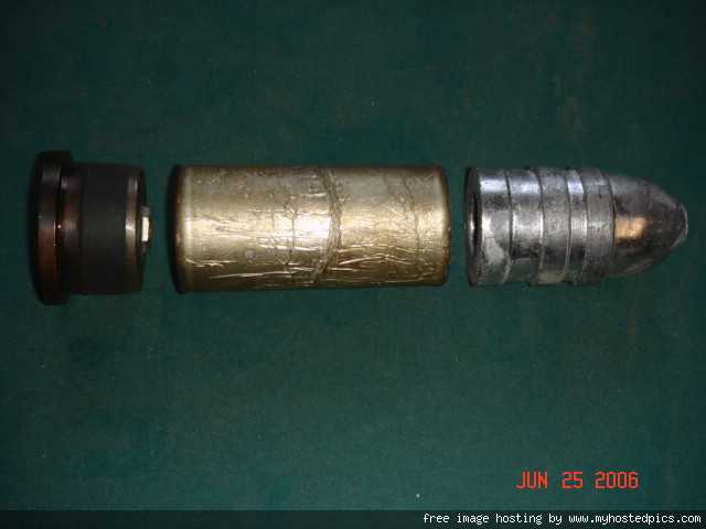

Just came on line with My Hosted Pics so here are a few photos of my 40 mm.Its due for paint soon.

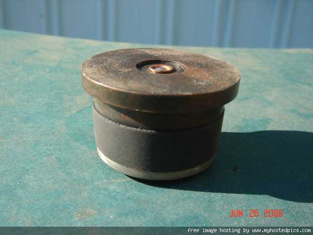

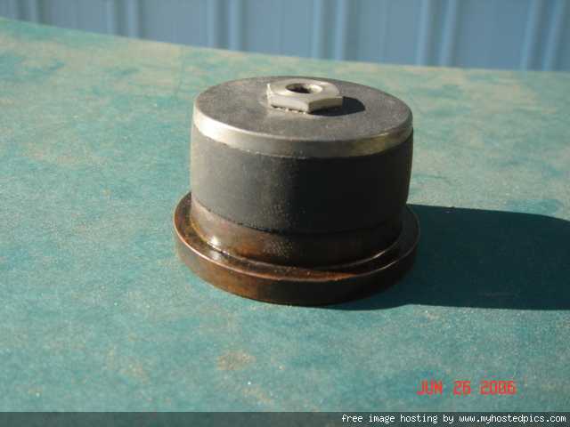

Those were great pics of your 40mm. On the pic of the projectile and load what is the metal part. I'm assuming it's to seal the bore and prevent gasses from leaking but what is it made of?

The base plug is rubber with a steel plate vulcanized to it , it is bolted to a copper rim by a stainless steel bolt that is drilled for a shotgun primer. 100% seal works very well.The fit on the plug can be adjusted by the bolt.

Thanks very ingenious I would have never thought of that.

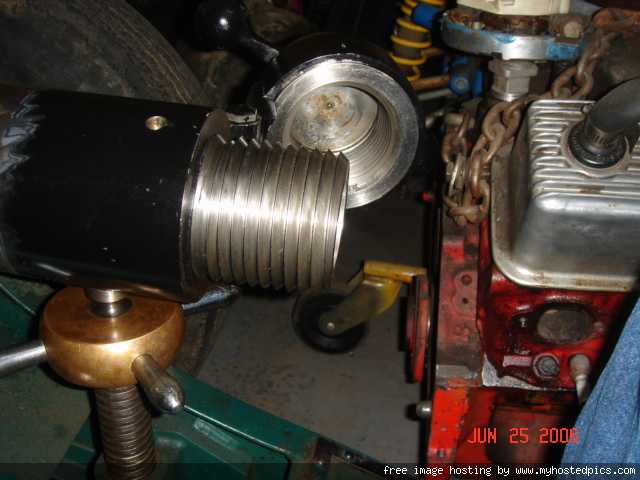

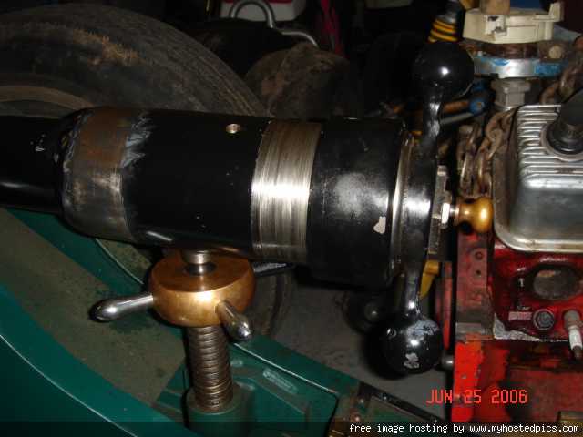

I just learned how to resize photos, so here is one of my 40 mm rifles.

That is a beautiful gun.  Tell us about the construction.  Where did you get the barrel?   What gun does it replicate. At first I thought it might be a Whitworth but then I'm not sure.  I think I have seen that gun design some where before.
You are going to  have to give us some details on the breeching system. How does it work?

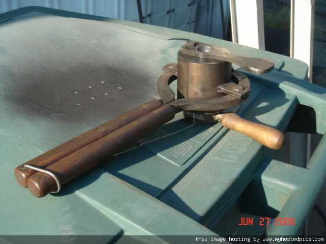

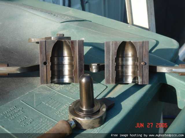

Who built your bullet mould?  Is the projectile zinc?  Where are you shooting?

My barrels came from the ship scrap yards in Portland Oregon in the mid 70`s.I got the last 3in-50 barrel they had for $50.00. I missed the piles of 40mm barrels stacked up like fire wood,but i did see dumpsters full of 3&4 foot 40mm barrels for .20 cents a pound,bought 3 of them. Spent most of my mony on 3 in barrels. It makes me sick to think that most of the barrels were shipped overseas and melted down.I was going to school at the time and didn`t have alot of money .The 40mm barrels are modeled after the Whintworth Rifle with a few more modern adaptations.I have my own shop so I do all my own work, sure is fun!

That is a nice looking mold you have there.

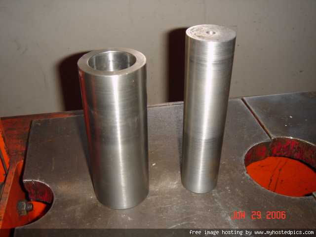

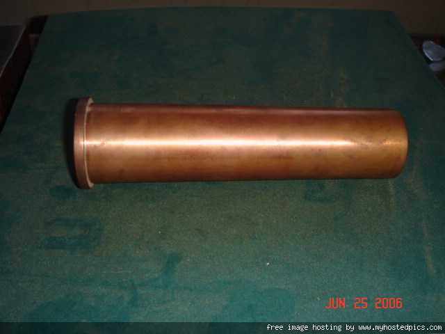

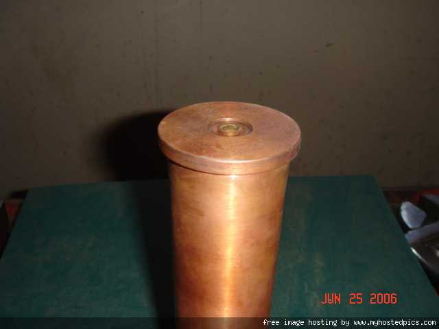

Powder Keg, Did you know that cases are fairly simple to make?They can be formed out of brass or copper.Once the formers are made its just a matter of cranking them out.Here are photos of my 40mm copper cases I use for blanks.

The formers are simple for the cases.The trick is to find stock tubing that is close to the size you need.The base has a 1/4in lip machined in it for fit in the tube,with .002in per side for silver solder.If you use copper for the base you have to reinforce the primer pocket,after a few rounds the primers are loose.Brass would work better for the base and copper works well for the tube.Fire form the cases for final fit(most fun).I can make a case in about 1/2hr.Anneal the tube before you try to form it .

I've never seen a "former" work? could you please explain it to me? It sounds like it would work best if the bases were machined from brass and the tube was copper pipe. The two are then just soldered togather. Right? Sounds easy enough. Also could you explain how you "fire form" your cases? Thanks for your help. It is fun to learn new things here on this forum.
