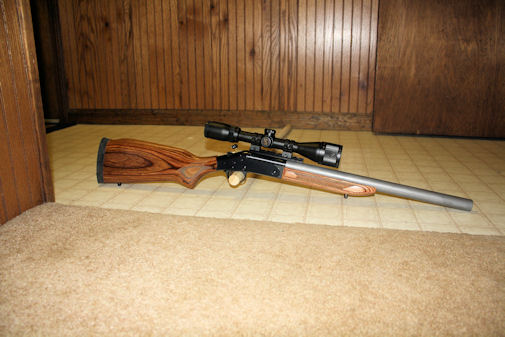

You can do what ever your heart desires, but I strongly recommend reaming 22 Hornets to the 22K Hornet. Mine shoots well with a variety of reloads using different powders. Here are some I have tried. My fire forming load of 9 grains of Lil'Gun and 55 grain full metal jacket bullets ( which were pulls; given to me free) works OK, but I do not have any pictures.
With Lil'Gun and 40 grain V-Max
With 1680 and a 50 grain MidSouth varmint nightmare
Here is a couple of more with the 34 grain MidSouth bullet, CCI 500 primers, Remington cases and WW 296 (my favorite load) and it is not a hot load.
It is no fluke that it shoots well, it shoots well with a lot of different reloads. These were all 5 shoot groups at 100 yards
Here is a picture of my 22K Hornet; it has a 1 - 14" twist barrel, my favorite twist for .224 caliber rifles ;D
In my humble opinion, the 22K Hornet is far superior to the regular Hornet.
Good Luck and Good Shooting
Offline moorepower
  • Posts: 518
Re: Ream Hornet to .218 Bee?
« Reply #12 on: October 03, 2010, 06:02:13 AM »
That almost does not look like a factory barrel!
Offline guns-o-fun
  • Trade Count: (27)
  • Posts: 536
« Reply #13 on: October 03, 2010, 06:19:09 AM »
I'll say.  Did H&R once make an ultra or ultracomp or something in 22 Hornet with a bull barrel?  I have cut my standard back to 19 inches and it seems heavy enough with that little hole through it.  Don't think I need any kind of bull barrel.  Nice gun.
  • Posts: 43311
« Reply #14 on: October 03, 2010, 06:47:17 AM »
LaOtto's K Hornet is a stub, H&R has only made one Hornet bull barrel, Shaner has it and it's 24" ta boot, it's a one off mistake Gardner made for some reason, he called and asked, they said they had it, he had it fitted to his frame, lucky fella he is!!  ;D  Ultracomps were only made in 270 and 30-06.
