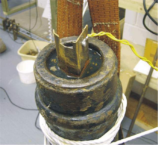

I'm electrolysing the bores to remove the rust right now, but I did put one on it's carriage when I got it home and took this picture.
A full description and explanation of the process you are using for this would be most welcome.  How about a making a ne spearate posting on this.

Might be better to describe de-rusting a cannon after I've actually done one, but I will say that electrolysis seems very easy and extremely effective...
