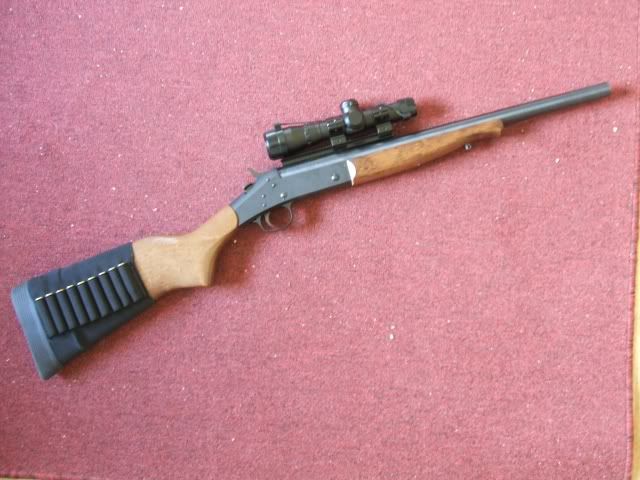

As some of you may know, I purchased a 357 max from canon a while back.  Well I shot it and it had a major forend problem.  It would "pattern" at 30 yards with the forend on, but with it off, it would shoot one hole with winchester white box 38's.  So I did some sanding and went back to shooting.  Well it helped but was not as good as with it off.  To fix this, I bedded the forearm with blue RTV silicone and added some paint.  Everyone knows a good looking rifle shoots better.
Before:
It had some scuff marks on the stock and it wasn't any thing special.

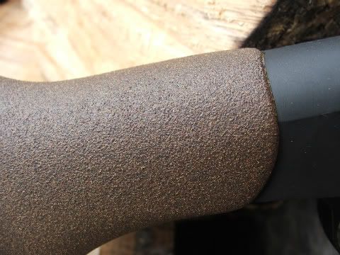

After:
I used Rustoleum Brown Textured stone paint over grey primer.  I did some reshaping on the forearm as well so it matches the size of the gun.
The texture really sticks out and helps the gun "stick" to your hands.
I wasn't real sure about the color, but it is really growing on me.  I am going to shoot it this weekend and hopefully produce something better out of it.  Now if I could only find some AA 1680  :-\

BTW, which scope is that - it looks pretty cool on there too.  8)

Thanks for all the comments guys.  I wasn't expecting quite this many.  The scope is a 2.5 power simmons 8 Point.  I'm happy with it so far, I may put a 4 power on it later for just a bit more range.
When I went to get the paint I was set on Black with Black flecks but decided that it would look like synthetic and I wanted something unique.  They only had the gray, lighter brown and this brown.  I would have definitely gone with the OD Green had they had it.  That would make a slick looking rifle.
I went to Cabelas over the weekend and tried to find some AA1680 with no luck.  I did however find some 180gr XTP's to try out in it.  I plan on hunting with them this fall out of my 357 S&W as well so it worked out.
The finish on this gun is thin to say the least.  Has anyone tried Duracoat on their stuff?  I have a bottle for other reasons and thought about coating this gun eventually.  What do you do about the breach face and the barrel face?  I would think it would have head space issues or not close up, let alone not hold up to the pressure.

Others here know a lot more than me but since this thread is about to slide off the page: Keep the coatings or paint off the barrel and breach face. In those places the finish won't stay if the gun needs tightening up and if the gun is tight already it can cause the gun to not lock up. I have read here not to paint those surfaces. eddiegjr (Your gun looks good.)
