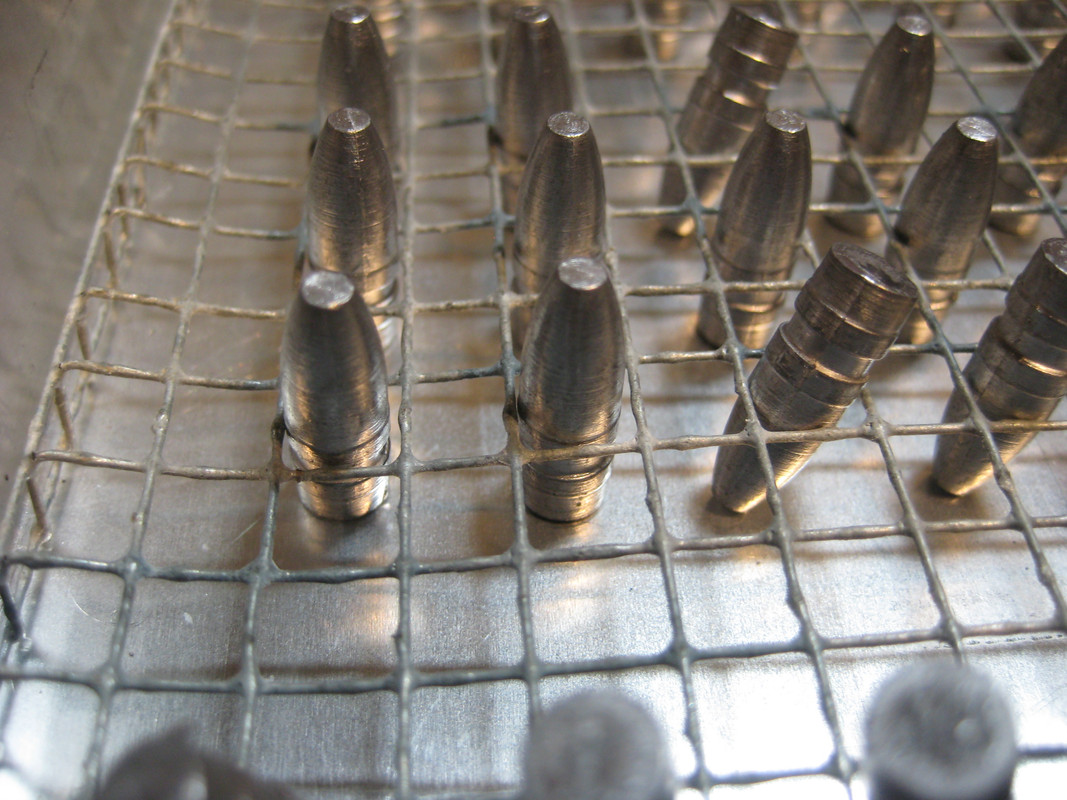

I've dabbled in it, but only "so far".
#2 & #4 are respectively Smokes yellow and black.  #1 is GC'd, and sized.  #3 is GC'd, sized, and lubed.
