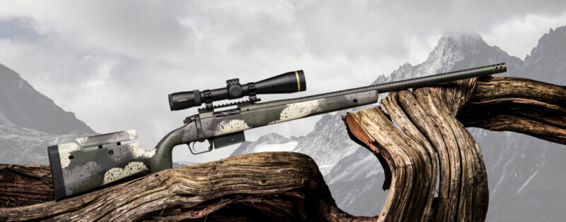

The new Model 2020 Waypoint from Springfield Armory combines old-fashioned quality with cutting-edge design and materials.
Enter the new Model 2020 Waypoint rifle, the first new bolt-action rifle with the Springfield Armory name since cars all sported spoked wheels. And this premium American-made firearm represents the company’s move into the competitive field of bolt-action hunting rifles.

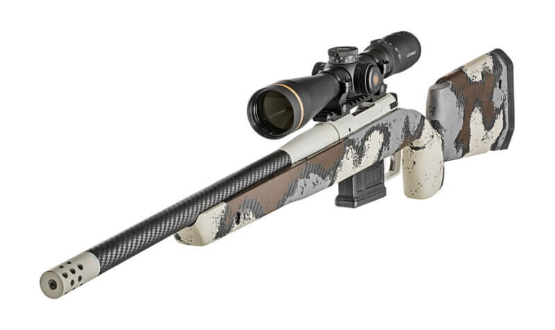

Depending on your age, you could call it a hunting rifle or a long-range match rifle. Old-timers can hardly envision a sporter with the Waypoint’s hand-laid carbon fiber stock. Its steep grip and tall comb, reinforced M-Lok slots in the forend belly and five QD swivel cavities reflect tastes and priorities of a new generation.
A carbon fiber stock and available carbon fiber-sleeved barrel helps the rifle be both ruggedly strong and portably light.
On the other hand, even shooters who recall the Truman Doctrine approve light weight. The Waypoint’s stock scales just 1 lb. 15 oz, with a standard comb, and 2 lbs. 11 oz. with adjustable cheek rest. Supplied by AG Composites, the stock is pillar bedded, has a 1″ Pachmayr Decelerator pad, and is available in Evergreen and Ridgeline Camo finish options.

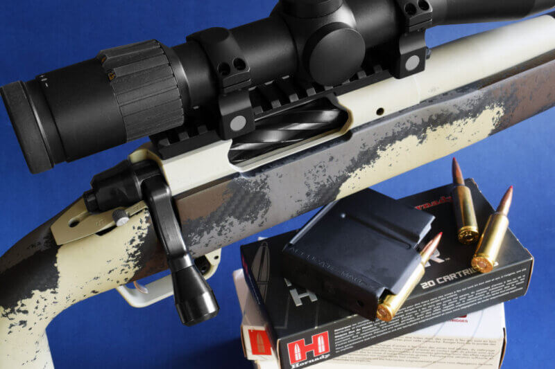

A spiral-fluted, two-lug bolt glides in raceways electrical discharge machine (EDM) cut in the stainless receiver. This ensures precise dimensions and slickly smooth surfaces. The bolt and receiver are machined after heat-treating to ensure the dimensions of the finished steel match specifications. Additionally, the bolt is nitrided for wear and corrosion resistance.
The TriggerTech “Field” trigger is externally adjustable, 2½ to 5 lbs.
Dual cocking cams boost the bolt’s already-easy 90-degree lift, and afford tool-free disassembly. The knurled, cylindrical bolt knob is removable. The Waypoint’s recoil lugs are integral with the receiver ring, and four 6-48 screws and two recoil pins secure the Picatinny top rail. Receiver, bottom metal, barrel shank and muzzle brake are Cerakoted. Springfield Armory settled on a detachable AICS-pattern, single-stack magazine, for sure, slick, centerline feeding. It is securely held but easily released by a latch inside the triggerguard.

Chambered in 6mm Creedmoor, 6.5 Creedmoor, 6.5 PRC (Precision Rifle Cartridge) and .308, the Waypoint offers BSF carbon fiber sleeved barrels as well as standard fluted stainless barrels. Twist rates accommodate the long, ballistically efficient bullets now popular with hunters and long-range target shooters: one turn in 7½” for the 6mm Creedmoor, 1:8″ for the 6.5 Creedmoor, and 1:10″ for the .308. All barrels are free-floated and threaded 5/8-24 for the included SA Radial Muzzle Brake.
The rifle’s smooth, cylindrical knob is replaceable, and the spiral-fluted bolt ran like an oiled piston for Wayne.
According to Springfield Armory, each BSF barrel is “jacketed in a roll-wrapped carbon fiber sleeve and loaded under tension [so] 95 percent of the sleeve doesn’t contact the barrel, providing cooling air gaps and promoting cold bore to warm bore repeatability.” Fluting under that sleeve trims weight and increases surface cooling area. The proof of any barrel, however, lies in the measure of shot dispersion. The Waypoint boasts a .75 MOA guarantee with match-grade factory loads and a skilled shooter.

To my mind, the Waypoint’s bolt shank has just the right outward sweep. It drops nicely in front of my trigger finger. The cylindrical knob is well proportioned and properly smooth for fast cycling. The shroud is trim, cleanly shaped. Vertical in form, the striker protrudes 3/16 when cocked. No unnecessary bulk or colors back there. Bolt travel is piston-slick, with almost no rattle. There’s very little end play at full retraction.
Running this rifle is a delight! It slurps cartridges seamlessly from the box and is easy to top-feed with single rounds. The magazine is a cinch to release and easily inserted. It’s secure in the rifle. Encouraged, it has a little play.

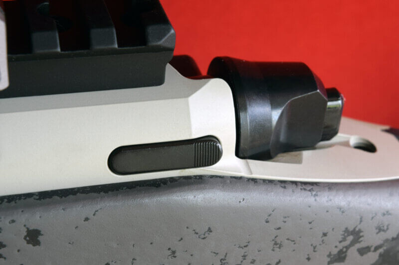

The Waypoint’s left-side bolt release is tidy, sleek, finely grooved and well-fitted.
Extraction and ejection are fault-free. The extractor is inserted though a slot in the center of the right-hand (lower) locking lug. Beefy shoulders hold it securely and resist breakage, should you get too ambitious with handloads and stick a case. The claw itself is 6mm wide across most of its face, 5mm at its leading edge. The face angle makes for easy push-feed engagement. The Waypoint’s plunger ejector is peppy and kicks from 4 o’clock.

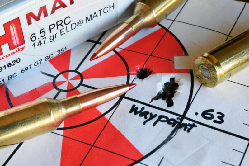

The barrel-diameter SA Radial Muzzle Brake, Cerakoted to match the action, is very effective. Recoil from Hornady’s 6.5 PRC loads thrusting 147-gr. ELD Match bullets at 2,910 fps hardly bumps my cheek or clavicle. The Decelerator pad adds its cushion. The Waypoint’s crisp trigger also encourages tight groups.
Enlarging bullet holes with the next shot seemed the Waypoint’s habit. This is superb out-of-the-box accuracy.
How tight? My first three shots, after bore-sighting and two to zero, cut a .62 knot. I printed some more groups, which measured .63 and .70. Such accuracy from a rifle that, stripped, scales under 6¾ lbs. should please any shooter! It’s also a credit to Hornady’s excellent ammunition.
