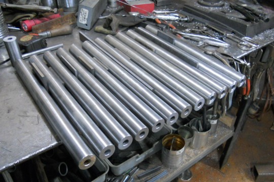

I've been wanting to build a breech loading multi barrel gun for a while and I finally started on one.  I am making this like the Requa volley gun of the Civil War.  The Gatling guns are cool but there's a lot of them around.  I don't see too many of these.  This one will be a 12 barrel model [that's what I currently have enough material for].  I have enough material for 13 barrels but some think that's unlucky so I'll stick with 12.  The barrels will be about 18"overall length including the breech sleeves and are 50 caliber. I was facing the tubes this evening and the bolt broke on my mandrel that I use to chuck the tubes in the lathe.  I have to face the end facing the chuck because the tubes are too long for the lathe.  I replace the bolt with a grade 8.   More photos to come as work continues.
Broken facing mandrel  :(

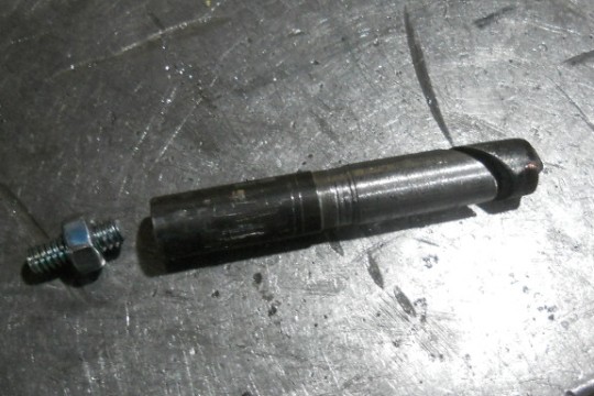

'an alla that damage just 'cause ya looked at it?
sorry Dom, couldn't resist, now I'll go to my room.
Ok, I didn't get it til I read Tracy's post.  :)   I was still in machinist's mode when I first read it.

 My idle mind went into devil's workshop mode, so I dug out a bundle of 6" long 3/16 ID x 5/16 OD 304 seamless tubes. I have enough to make a BB volley gun with ~100 barrels.  ;D
 I was thinking to take a 1/2 x 1" bar of 303 I've got, bore 20 holes and heat-shrink the tubes into it. Flash holes and a groove milled for the powder train and voila; a muzzle-loading mouse blaster.  :)

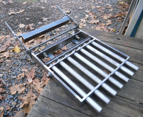

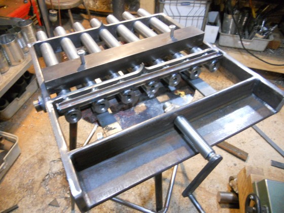

« Reply #10 on: November 11, 2012, 03:33:34 AM »

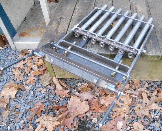

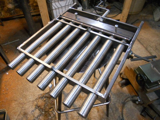

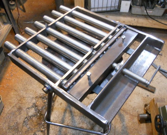

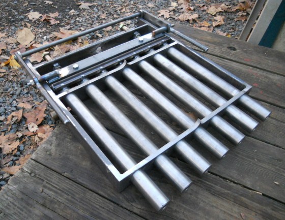

I finished the fabrication work on the volley gun.  I reduced it to 7 barrels from the original plan of 12.  The tubes are cold drawn seamless and the bore is not centered with the OD of the tube, so I could not use the cartridge sleeve idea for the breeches.  It's off centered about 15 thousands.   What I did instead was to make a heavy breech block that butts up behind the tubes.  The threaded rod and crank holds it firmly against the rear of the barrels.  The two bolts on the top of the block are the temporary handles for lifting the breech block.  I will video the test firing.

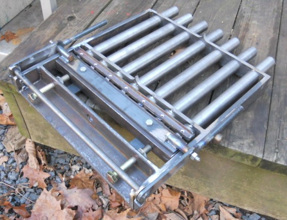

Interesting concept though I am troubled by the centerd lockup..... I think you may want one near either end..... I am interested in seeing the test firing on this one..... Dom, don't take it as critisim I tend to overengineer ......
Offline dominick
  • Trade Count: (21)
  • Posts: 1367
Re: Volley gun project
« Reply #14 on: November 12, 2012, 11:14:14 AM »
KABAR,  thanks for pointing this out.  I gave it a bit of thought prior to installing the single screw. I wanted the quickest and simplest reloading method possible.  I feel the single screw is sufficient because of the rigidness and weight of the breechblock.  It is solid 1-1/4" x 2" steel.  Since there is only one barrel firing at a time, only one barrel will be trying to separate the block from the rear of the all of barrels.  When Number one barrel fires, the breech block will momentarily be loaded against number seven barrel with a force slightly less than what # 1 barrel will exert and at the very most, roughly double on the center screw.  There should not be any flex in the unit ample enough to cause separation.  I'm making up aluminum foil cartridges that should seal most if not all of the gas leakage between the block and the rear of the barrel.  I still need the mill across the rear of the barrels to have a tight mating surface with all of the barrels and the block assembly.  If there is an unforseen problem with this arrangement it will be changed.  What do you think?  Dom
« Reply #15 on: November 12, 2012, 12:47:59 PM »
Only change I would make is to close the top of the back part (make it like a deep channel) so the part the screw is mounted to cannot deflect due to the unsupported top.
Offline dominick
  • Trade Count: (21)
  • Posts: 1367
« Reply #16 on: November 12, 2012, 01:19:41 PM »
  Good idea!  Thanks.

Sounds well thought out, my only thought is while each barrel fires one at a time it is a very short time between firings in fact the next barrel may already be engaged as the pressure curve from the first is dropped off.... this will be an interesting test.... wishing success!

Allen,  I am thinking of changing the the breech block to replicate the Requa gun.  I  may change it to two smaller tightening screws at each end anyway and have two levers at each to lift out the breech block. I'm also changing to fine thread on the locking bolts.  Dom

« Reply #19 on: November 14, 2012, 12:40:36 PM »
Well Allen I liked your idea and went with it. Thanks.  In addition to the two locking bolts, I made it resemble a requa gun more closely.  I added the levers for opening the breech.  The Requa patent show 7 barrels and there is a reenactor's replica that is also 7 barrels.  I don't feel so bad reducing it to 7 barrels from the original 12.
« Reply #20 on: November 14, 2012, 02:35:48 PM »
Still think you should close the top of the breech screw bay.

« Reply #21 on: November 15, 2012, 01:17:52 AM »
I wasn't sure whether it's still needed with the bolts closer to the side frames.  Wouldn't hurt to add it anyway so I will.  Thanks.
« Reply #23 on: November 15, 2012, 12:57:08 PM »
Now that looks much better! I take it that the breech block is allowed to slide on the frame so the locking bolts jam it forward?
« Reply #24 on: November 15, 2012, 01:41:08 PM »
Yes,  There's a few thousands clearance to allow free movemnt of the breech block.  The bolt only need to be loosened less than A 1/4 turn to lift the block out.  I also closed in the top of the angle to form a channel.  That makes it look better too.

I was thinking of an adjustable cam over lock up on each end of the breach block levers. Similar to the cam levers in the old 73 Winchester rifles. More complicated than your design though. I too tend to over engineer.   ;D  Good work !

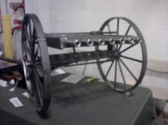

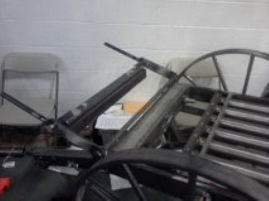

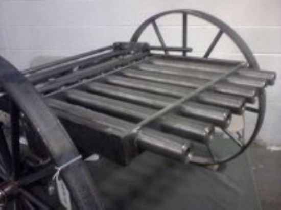

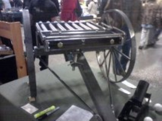

« Reply #29 on: April 14, 2013, 03:18:11 AM »
I finally had help tio figure out how to upload the photos from my cell phone that I took of the volley gun.  Here they are.  Sorry for the poor quality, the photos stored as thumbnails on the phone.
