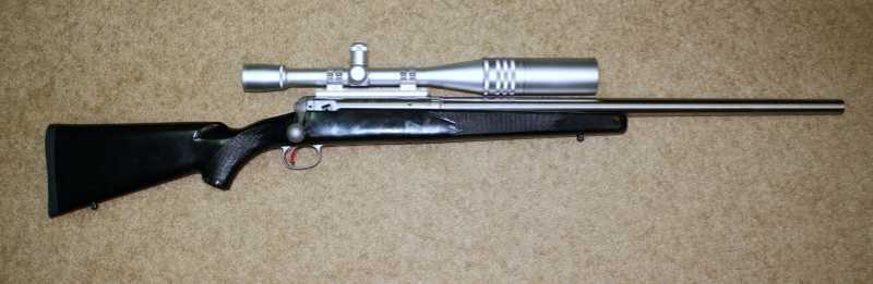

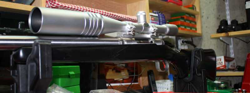

I just got my new barrel and set it on the action. I am still waiting on the stock. the stock ordered is a laminated Blue/Blue/Black Varmint stock with a heavy barrel channel. I used this old stock to just get things going and get some loads made up and zero the scope while I wait on the final stock. Here are a couple of pictures.
BTW it is a Savage Target action with right bolt and left port. I had the barrel made in 222 Remington. I really like the triple deuce thus laotto222, my first varmint rifle was a Remington 788 in 222 Remington and it was very accurate. This is a Brux barrel with 1-14" twist. The scope is a Weaver Target series that has fine cross hairs with 1/8" dot and is 36X. It weighs in at 9.8 pounds. The laminated stock will get it near 10.5 pounds.

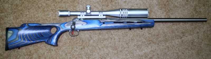

I got tired of waiting for the stock from Sharp Shooters Supply, so I ordered one from Boyd's Stocks. Here is a picture of it.
I still will get the other stock some day, but I have been waiting for 8 months and I just did not want to wait any more. I can't wait to see how it shoots. If every thing goes well, I will be able to try it out next Saturday at the Ohio Shoot. It weighs 10.6 pounds as it sets.

Thank You, I think it is rather handsome myself. I have not installed pillars or bedded the action. I would, but this is not the last stock it will reside in. I still have a stock coming from SSS and it comes with 3 pillars and I will bed the action. It is Blue, Blue, light blue laminate. This stock only has two action screws, so that is what I put in it. The action I have has three and I could drill it for the third, but I do not want to do that yet. I will save this stock for a later build and will bed it and put pillars in for that build. I was just getting anxious to get some trigger time with it.

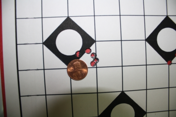

I had a chance to shoot it last Saturday. It was chilly and breezy 10-15 mph quartering left to right. I was shooting 1" high at 100 yards. I was shooting some single hole groups at 100 so I decided to move back to 200 yds to see what it would do.
The group measured .630". I felt pretty good considering the wind and I was fire forming and doing load development. It felt pretty sweet shooting. I got several positive comments on it's looks and plenty of questions. The load was Laupa brass, Rem 71/2 primer, 50 grain V-Max and H322 powder. The bullet had a .020" jump to the lands. Lots of more work to do, but I like where it is going. I cleaned the barrel once and sent about 100 rounds down range. It seemed to shoot better as I went.
