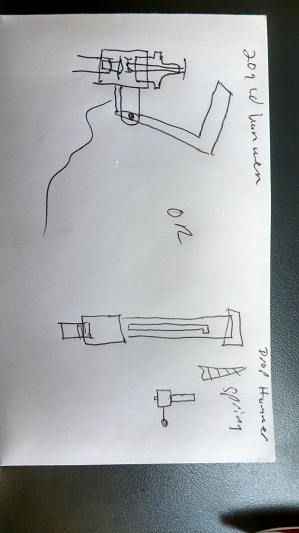

Touch hole liner with lock questions
« on: February 19, 2013, 06:08:13 AM »
Your site is great, I'm just getting my first hern 1/2 napoleon in a few weeks.I want to make sure I do every thing the correct way. Reading here you must line the touch hole so my question is can I do this safely I will post a pic of my idea. This is not the bolt I would use just for the idea.I want to fire using 209 primers. Thanks Dallas this newbie can use lots of help.

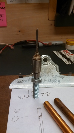

I can see the drawing with the lanyard to pull; so in the photo, is that the spring activated firing mechanism that will pop the shotgun primer (set on top of the bolt)?

Here is my ideas.Thanks

« Reply #3 on: February 19, 2013, 07:43:28 AM »
Read your post wrong sorry. Yes it will be on ss bolt, with 209 primmer as charge down through 1/8 or 3/16 hole in bolt to fire charge?
Re: Touch hole liner with lock questions
« Reply #4 on: February 19, 2013, 07:56:15 AM »
Okay, thanks, now I got it. You're going to have a slap hammer that will strike the cap.
« Reply #5 on: February 19, 2013, 08:13:33 AM »
Are you going to charge your vent?   How?  Will a 209 primer throw enough fire to reach the charge down the vent without being primed.
Your whole system seems excessively complicated and overly complex for firing a 1/2 scale Napoleon.  In fact firing a gun that large there is a very good chance you will just blow the whole mechanism right out of the gun in a few shots if not sooner.  I Base this opinion on what appears to be some sort of closed spring loaded device.  Slap hammer should be okay.   You are just asking for an accident if you have screw that spring loaded device into the vent of a loaded and primed gun.  I value my fingers.
You best way to fire the gun is with a quill or friction primer-that's how the originals were fired.  Friction primers are easy to get and much cooler and more authentic than mechanical devices.
If you must have a mechanical device, then look at a slap hammer firing a musket cap down a primed vent or firing a power stud blank.

Thanks for the help I think I am going to go with a touch hole That can go with 209 at a latter date so I can start with fuse and quill [have pic of 209 nipple].I'll try to post pics later myhostedpics off line. Getting my antique steel wheels for carriage sat. ? New house monday so I'll try to post the pics soon.
