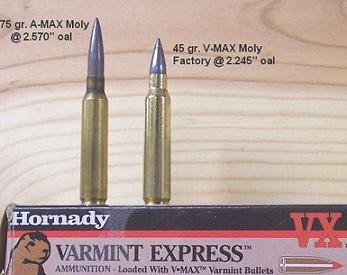

Here's a good example of what my Handi 223 with 1:9 twist bullet load sitting 0.010" off the lands looks like. Another I load is the Win. 64 gr. PP and it touches the lands at 2.440".
In my other Handi 223 with 1:12 twist I just do as Tim suggests, just load at SAAMI specs.
