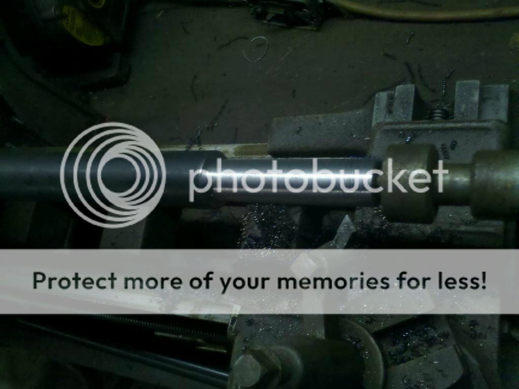

« Reply #17 on: January 05, 2013, 04:35:12 PM »
Offline jkpq45
  • Posts: 278
Re: stub idea and question
« Reply #18 on: January 05, 2013, 04:46:06 PM »
looks like you're making some serious progress!  the potential of the handi platform is quite a lot once you have access to the proper tools don't you agree?
Offline Mr BadWrench
  • Posts: 32
« Reply #19 on: January 05, 2013, 05:31:48 PM »
The funny part is, the guy who owns the lathe wants one and another friend wants one too... The two of them figured out a much simpler way to do the stub that what I had planned.
